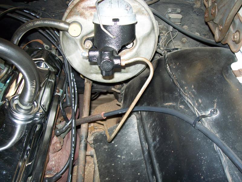

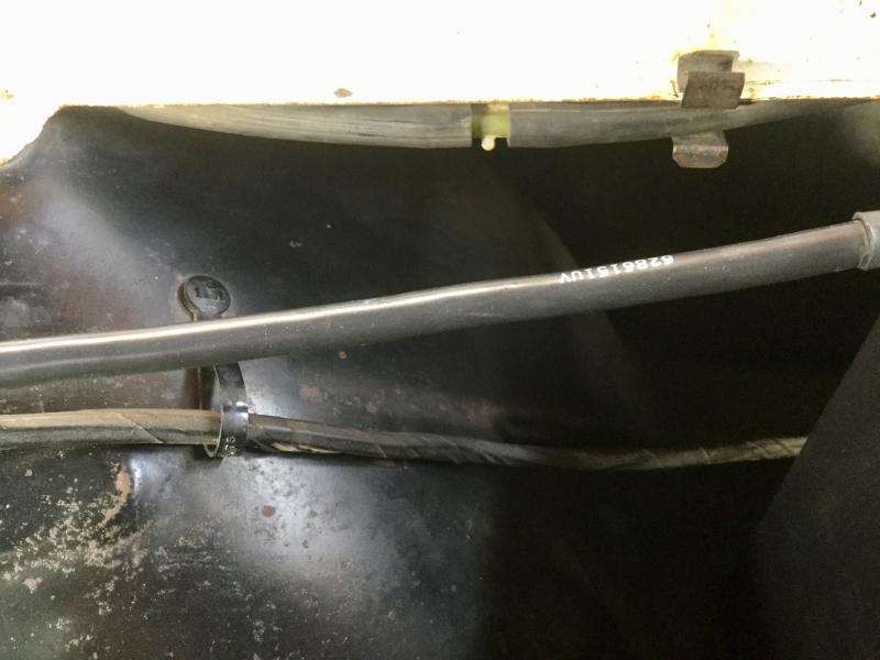

Also,does anyone have a schematic or picture, as to the routing of the washer hose from the container to the pump? I know it goes across and under the fan shield on the radiator and across the radiator support. How about from the driver side of radiatior support along the fender to the pump?

The hose is run from the pump up over the inner tub, behind the fender bolt points and then back out across the top of the support.
Not sure how hard core you are but the unique piece of the WW hose is the factory splice used on the DS.
This was due to washer jugs for the 6cly were on the DS and 8cyl on the PS, so the factory just spliced the hose to run further on the V8.
Hope this helps.

Here's a pic of the Hose Clip used to hold it to the fender flange.
