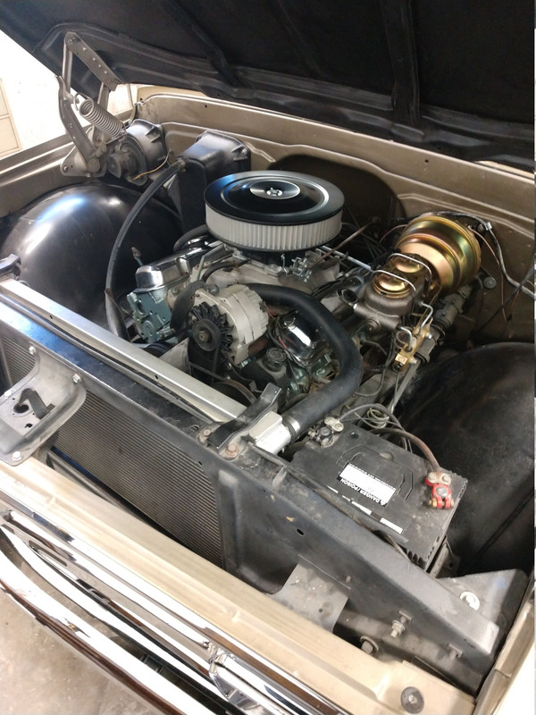

Old 06-02-2026, 05:49 PM
buds56's Avatar
buds56 buds56 is offline
Location: manassas va
Posts: 183
Pretty easy
I used clamshells and brackets out of a 73 up truck and the motor mounts from a 71-76 full size Pontiac
