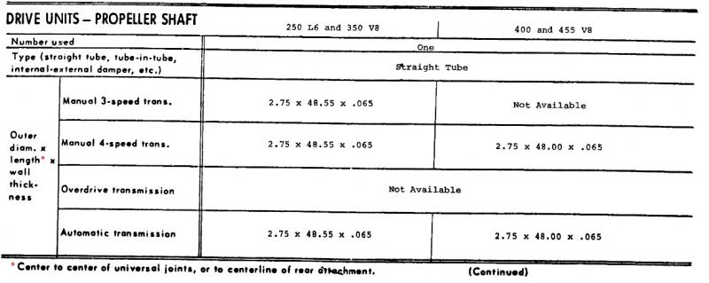

Here is the AMA spec for 1970...

ok - thank you VERY much HFR!!
Is it correct to assume that the 49.2" vs 48" is a center to center of u-joint measurement?
1970 Formula 400
Old 06-04-2026, 02:29 PM
Posts: 22,514
Yes.
Correct. Here is the 1970 Firebird Service Manual and 1971 and 72 AMA charts too.
