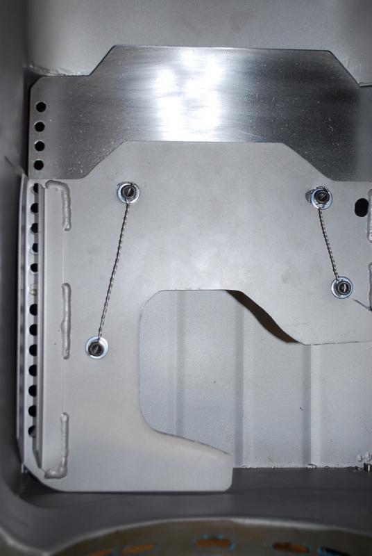

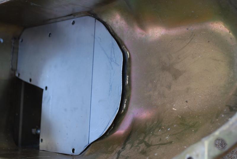

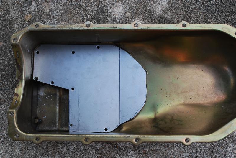

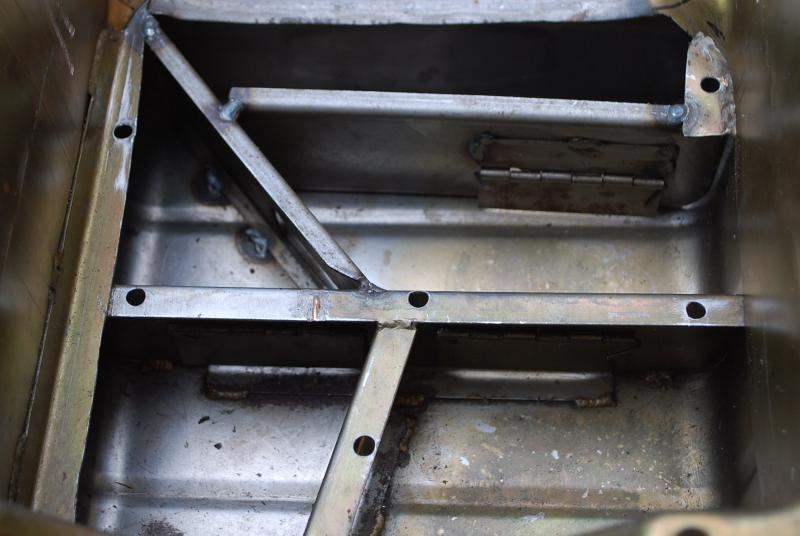

Update-cleaning out the garage a couple of weeks ago so I could bring a car back home form the shop and found this project thought I would try and finish. I had bought some trap doors from Canton and had a fabricator add some additional baffles with them. Mocked up a 22ga sheet metal tray then bought some 18ga sheet to duplicate it. I bent the front edge up a little so it can drain back in form the front-a little lip where milodon had cut then added the sump. Just nor sure where to add any additional drain holes. 5 trap doors.

Here is a Canton pan F body pan slightly different top trays on them. On on the pump gas 455 in the TA second slightly overlapping tray on the 500!A but I had the sump deepened 1".
