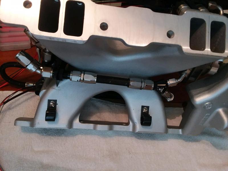

I divorced my crossover. I had no idea about the cooling port diameter. I used to use a 2bbl iron crossover, until I went efi. That required 1 threaded port for gauge temp, 1 port for efi.
Good to know, because I had to take a cooling journey a while back, and I was trying to determine the constraint. I did determine that there was a coolant flow constraint with a standard tstat, and that 1st gen radiators are stupid small. But all these items can stack to make a marginal cooling performer.
I really love the lack of crossover and air gap. It makes a great place to hide wiring and hoses.
Old 06-17-2026, 06:22 AM
HWYSTR455's Avatar
Location: Winchester, VA
Posts: 16,206
Agreed, there's tons of room under there wo the exhaust crossover to hide stuff!
