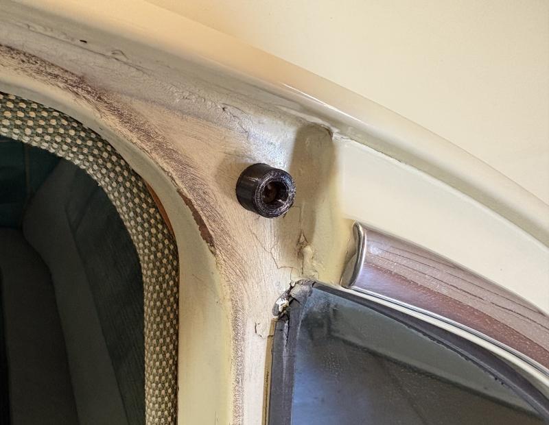

First, since CPR has been out of upper door bumpers for the past two orders, and Steele costs way too much, I started learning 3d modeling and made some bumpers myself from flexible rubberized filament.
