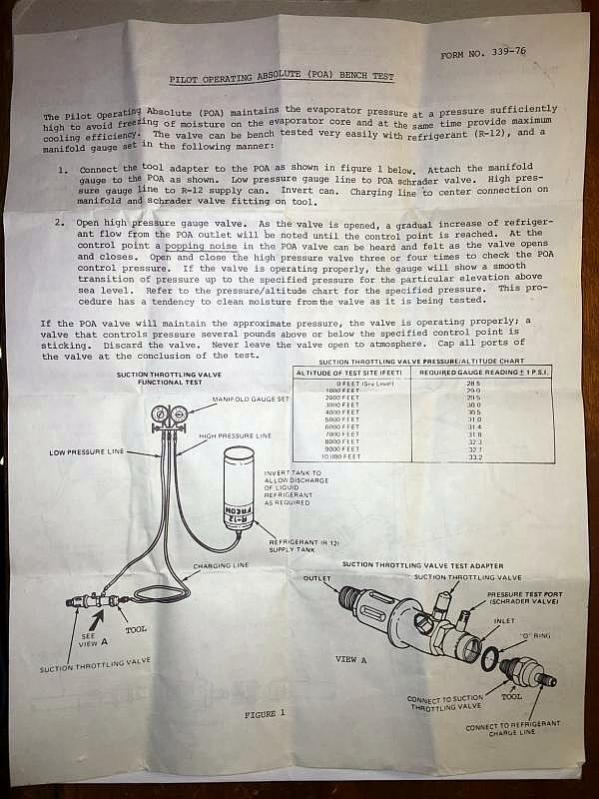

Since AC flush is expensive, I use lacquer thinner as an initial flush and then use the AC flush in a final cleaning. The POA can be flushed while connected to the evaporator or stand alone. I recommend that the POA be bench tested before installation and cleaning since the refrigerant and oil may have been burnt & contaminated causing the POA to stick. You can plot the input pressure vs output pressure and note the point the POA regulates the pressure. A bad one will show not regulation and the output will follow the input pressure.

Thank you for the swift reply and pictures. I'll be sure to check the screen. The POA testing your recommending - would the valve adjustment procedure for use with R134 accomplish the same thing? I can do that while it's attached to the evaporator. Or, should I make the adapter as you did and do it on the bench? Thanks.

You can test the POA while it's on the car by applying air pressure directly to the TXV inlet. At ambient temperature, a working TXV will be open and not restrict the flow. The photo shows a blowgun against the TXV.. I made a fixture to connect the air pressure to keep my hands free to record readings.
POA adjustment is on the evaporator side so having an adapter and bench testing makes it easier to teardown and reassemble.
