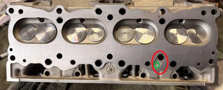

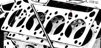

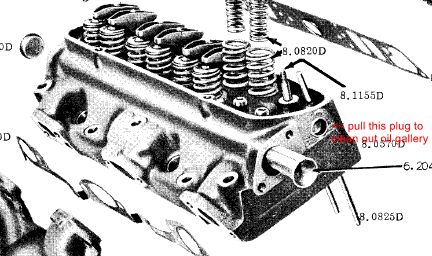

Questions remaining are:
1. Do the head gaskets have proper passageways for the oil flow to transition from the block to the heads? It is not a straight shot through a round hole. 2nd picture below shows the hole. The cut out in the head gasket is an oval. This drawing is of a pre-60 head that has cooling tubes that are fed directly from the water pump. Your 63 does not have these.
2. Did the shop that rebuilt the heads clean out the oil galleries? 1st picture shows the plug in one end of the head that needs to be removed to clean out the gallery. There is a plug in each end.

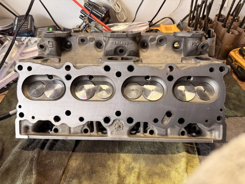

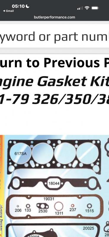

Thanks Mr. Hanlon,
I’m hoping my photos came through to the thread. If so, this is the gasket used (from Butler Performance) and my head. I believe that since the head gasket and head are symmetrical, I couldn’t have messed this up if I tried. It appears that if I flipped it or got it backwards, it still would not have blocked any hole.
As far as the head oil galleries, there are fresh plugs in both the front and rear of the galleries. The rear drivers side gallery actually has a little oil seepage coming from it. So it makes me feel that it’s getting to where it needs to, but after all this work, would like to really know before putting it back in the car. However, I did come to the conclusion last night that a prayer might be the best way to live forward. If two full turns of the crank has a few degrees of hole alignment for each head, then it’s essentially trying to find maybe ~4 degrees out of 360.
I agree. Picture below just highlights the channel in the head that the oil flows through. The green circle lines up with the oil passageway up from the #2 or #4 cam bearing depending on which side the head is mounted on.
If it is seeping a little now it'll leak later. Get it fixed before installing the engine.
