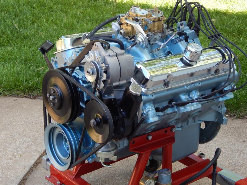

Pump is the later one with a return, it's new so we will run it for awhile. I like the filter up top with the return, it should help out if it vapor locks. Not sure if the bottom pulley should be blue or black, I just figured blue due to the way it's assembled. maybe they added the weight and pulleys after it was painted, but that seems like a extra step.
