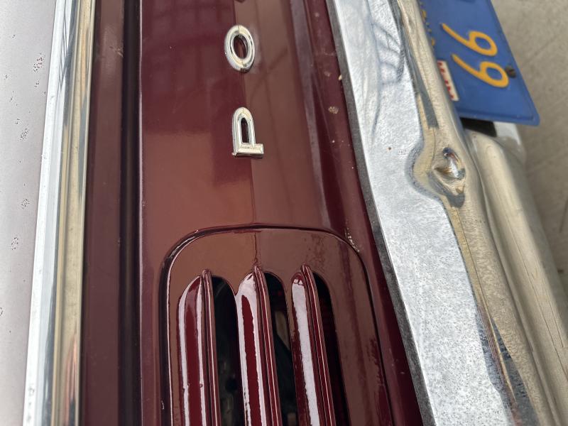

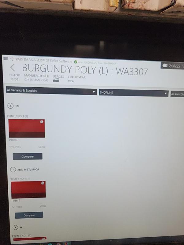

You're welcome! Here's what I found in our system at work yesterday. And also the color on my cowl. It is the Shopline (JB) version. Omni and Shopline are the same paint, just labeled differently for different distributors and you know, make things more difficult than they need to be. Our computer shows a gallon of Deltron (DBC) being about $2,400.00, where as the Shopline (JB) is about $350.00. We spray Deltron at out shop, and I sprayed out a sample of the prime (Standard) variant and is was way too brown looking compared to what I found on my car. The Shopline was a much better match. Some will say that Shopline won't cover as well, and you'll need an extra coat or two of color. To them I say, I'd rather spray a couple extra coats to have the color I want, and save the extra cash. There is no way that the Deltron is nearly 7 times a better product, I've sprayed them both enough over the last 14 years to say that in a lot of cases the Shopline/Omni system is superior. We only spray Deltron because they do have a better, well, more extensive color library.. that's not always what it's cracked up to be either.. Sorry, I got on a rant. I guess the point I was trying to make is, don't be afraid of the "lower level" paintline. Hope this helped.

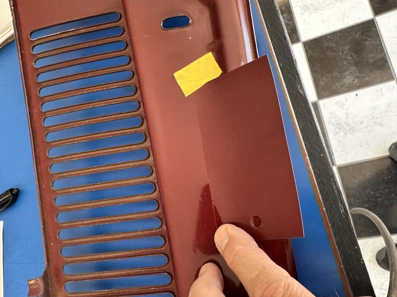

That spray out picture you posted looked way better than what I received from the other paint rep. I know it’s hard to judge colors by looking at a computer screen I can tell it’s closer than what I purchased a quart of. I’m not in the least concerned about the less expensive paint. Maybe if I was doing the whole car, but I’m only doing a fender. Johnny, did you paint the cowl or is that original? Do you have the mix code for the scan of your cowl in the Shopline paint? I think my mistake is that I limited myself to one automotive paint store which was Valspar. The fellow that works there is supposed to be the excellent at matching paint. Here was a spray out on an old fender.. |
That is the Shopline formula that I sprayed on my cowl. Your color looks very purple or bluer than what you sprayed on the fender. Deltron does have a variant they call "Darker Bluer" that might be the best choice, but unfortunately would be much more expensive. I'd have a small amount of the Shopline mixed and see how it looks. I wish you were local to me, I'm always up for a tinting challenge, especially on an old goat! If that fender is junk, you could cut a piece off and take it to your local ppg jobber and see if they could tint it around. Attached is the formula for the shopline mix and a computer generated comparison between Deltron Prime (standard) and the Darker Bluer variants. And also a couple more of my cowl and firewall.

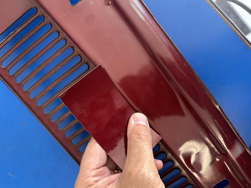

I went back to the PPG store on Friday to see if they could modify the paint I chose a week earlier.
I had a new quart mixed up and I had them remove all metal flake and add a tiny bit of black. Color match is great, painter (me) not so great. Still, I’m going to go with it. It’s a very close match. Thank you for all the help! |
