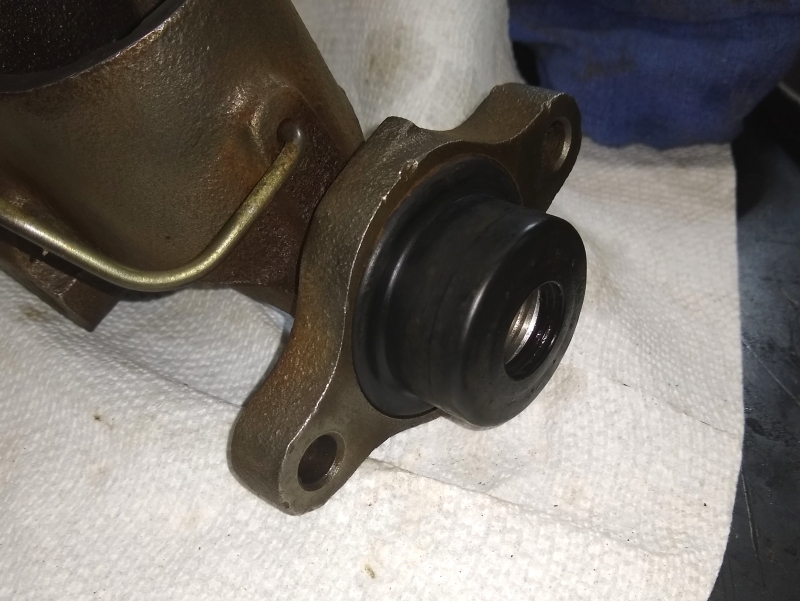

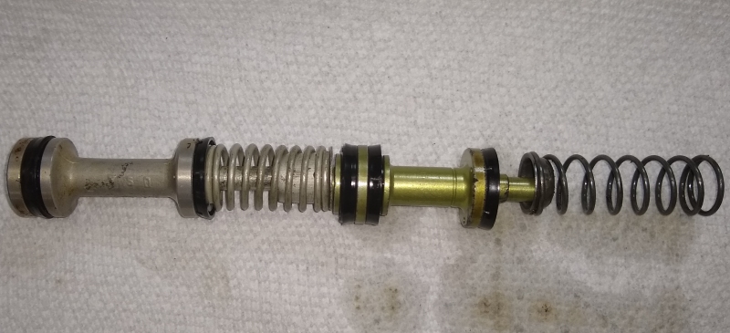

Couple of questions before I button this MC up.
Does the arrangement of the internal components appear correct? That is how they came out. ( I installed them about 7 years ago and it's worked fine).
And, what is the purpose of the large groove at the rear of the MC? It appears to have no function in my application ( all drum, power), also there is a pic of the rear boot I am using.
Also a pic of the cover gasket that was on it, obviously rust had compromised the seal a bit.

That cast body may also do duty as a manual master if machined differently.
The large groove around the outside of the bore most likely is seating for the rubber boot which retained the manual push rod. I was never able to source these boots separately.
I thought this rod retaining design was very poor in comparison to Mopar (deep hole in piston) and Ford (hole with one time locking clip). GM sometime in the early 70's dispensed with the shallow hole/boot design and went to a Ford-style clip. $0.02

Thank you, noticed one of my kits had the manual boot.
