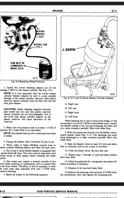

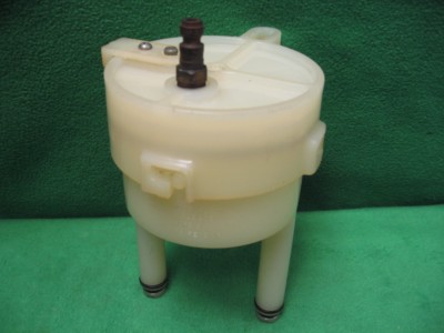

Factory service manual states use the Kent Moore J-26819 to bleed the master cylinder.
