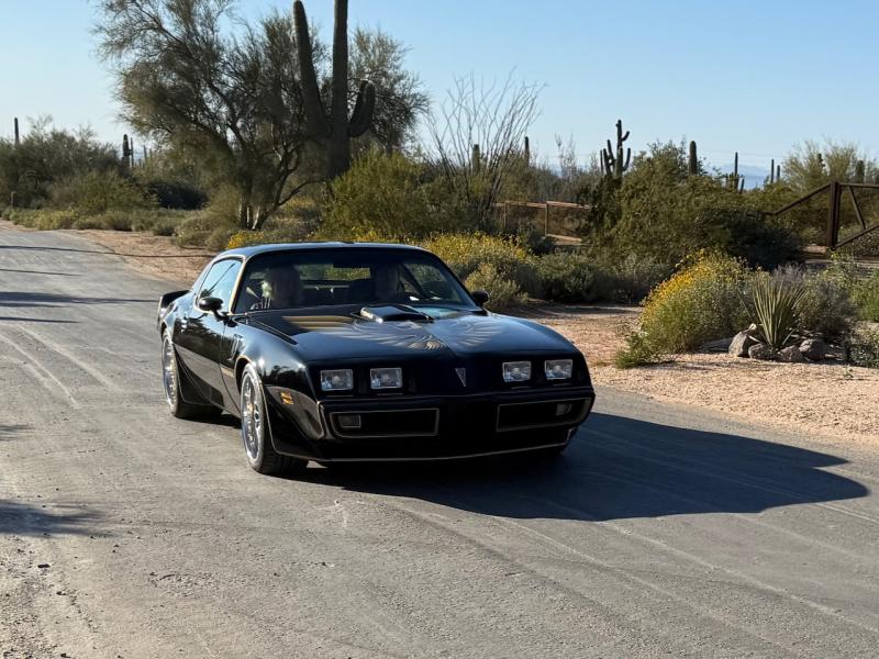

Exhaust and suspension are now completely sorted out. We got the A/C charged today, fueled her up, and took her on a nice long drive. It was only in the mid 90's, so maybe not the best test, but the system blows cold and the car doesn't get hot in traffic or idling at stoplights. etc. Next week we'll get an alignment. After that, polish & buff, SE decal/stripe install, and then ceramic coat. Once all that's done, we'll schedule another remote tuning session with Andrew to add A/C kick and make other refinements.

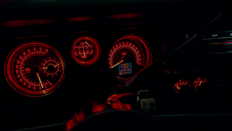

Been chipping away a couple hours at a time, but making progress. Tidied up under dash wiring, wired the reverse light and neutral safety switch from the TKX, labeled under dash/hood wiring, installed vintage air hoses, mounted Dakota Digital switch, adjusted the fuel pressure and voltage on the Vaporworx controller.
Hey nice gauges! They look very familiar 😉
The Dakota Digital RTX gauges are great...they maintain that factory gauge vibe so they don't look out of place in an old car, and are very easy to install and set-up. I run them in my '70 as well. The company's customer service is stellar, whenever I've had an issue, it's been resolved really quickly with no hassle.

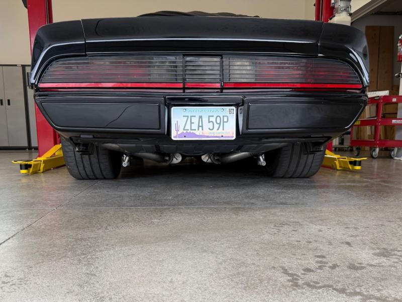

We weren't totally pleased with the placement of the exhaust tips...they didn't hang down far enough and angled inward...it just looked sloppy. We ended up redoing everything behind the muffler...it turned out much better than before.

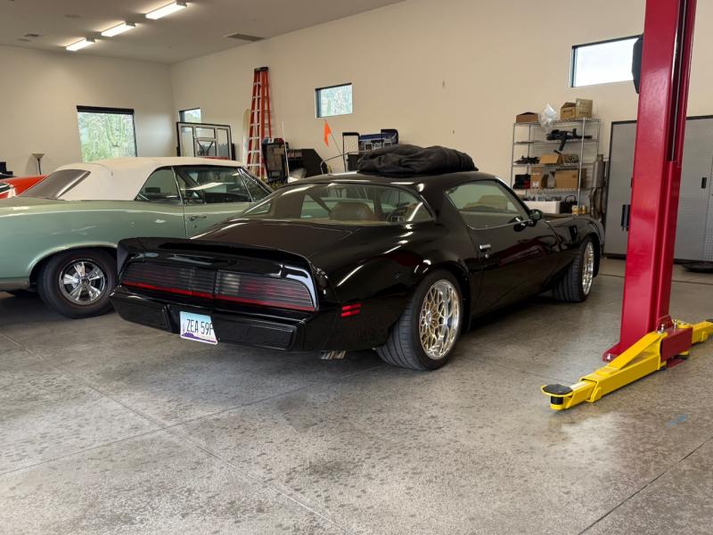

ID:	663270   Click image for larger version

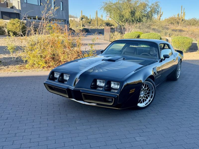

Started with the decals yesterday...there certainly are a lot of them. I didn't realize it would be a two day job...and probably another day to touch things up. Been looking at photos for the placement of the Trans Am decals on the front bumper and fenders, and the bird between the window and back glass.

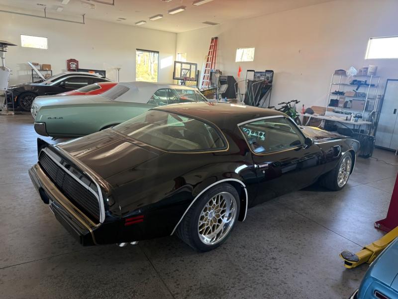

ID:	663398   Click image for larger version

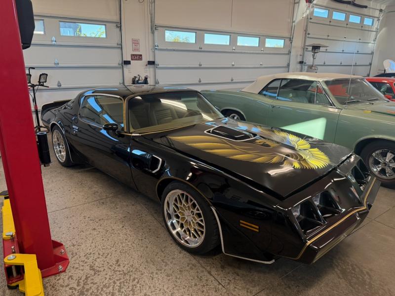

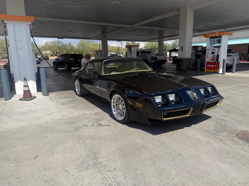

Decals are about done. Need to take care of a minor paint issue before we install the birds in the b pillar. Here are a couple photos...in one my son is returning from a drive with mom (her first time out in the car). The car's a great driver.
ID:	664674   Click image for larger version
