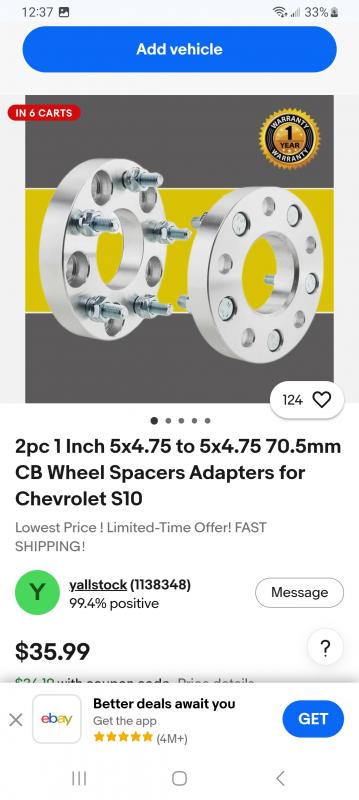

To double check hub centric balancing procedure here is what you do .After wheel is balanced to 0 or as close to 0 as possible ,have mechanic rotate wheel on shaft 90° then rebalance,most of the time it will need more weight or it wasn't correctly done the 1st time.I purchased my own tire balancer to get my rallys done right.Oem ralleys are harder to spin true than the reproduction rallys like Vintique.Ive got some stock Honeycomb and these things are almost a must to have lug centric adapter

Default Adapter I use instead of an old disk rotor
Adapter I use vs an old disk rotor

Posted a reply that did not show up. I bought and adapter like Joe posted to balance my Weld ProStars. They are actually 3 piece the outer and inner squeeze on a center portion as lug nuts tightened. The center can rattle around untightened. Hard to fine a lug centric balancer here in Houston!
