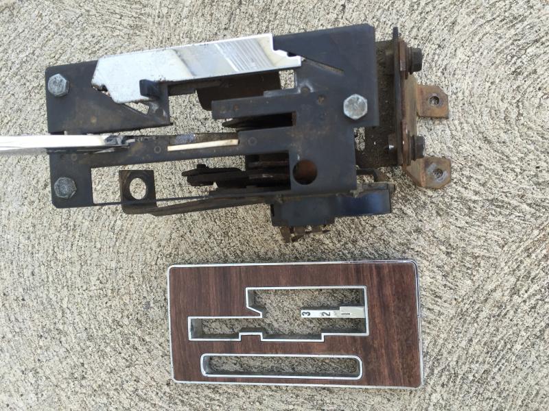

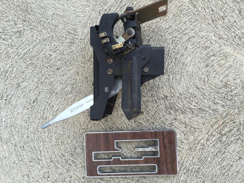

I have what is supposed to be a correct factory dual gate shifter. Is it the correct unit? If so how does the top plate attach? It has clips but looks like there are a couple brackets that bolt on the shifter the clips go thru? Pics are not real good but can take better ones if needed. Thanks, Jim

You're missing a plate that the fascia clips to. It attaches to the underside of the console first, then you screw it to the shifter body. It attaches with phillips screws rather than the bolts on your shifter.

Thank you. I thought something was missing.

You'll have to get rid of those bolts when you get the missing part, the fascia won't clip on if the bolts are used in most cases.

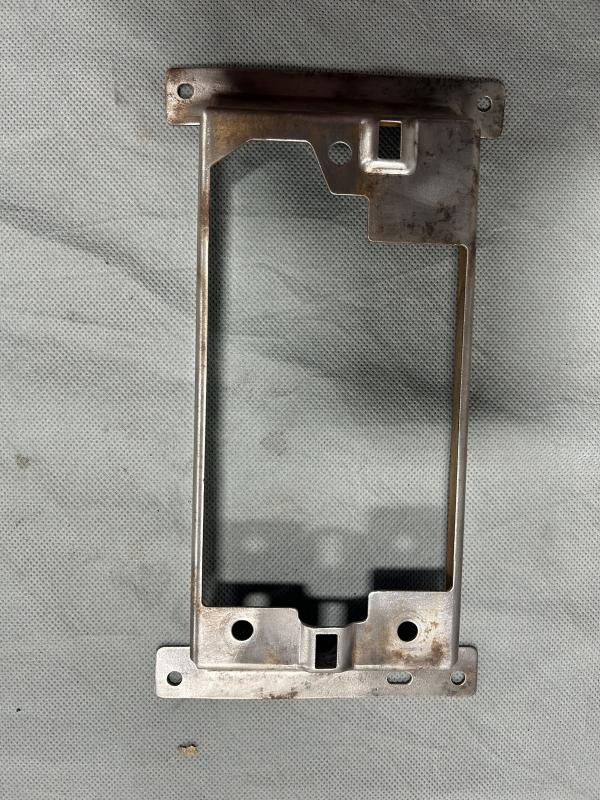

Is this plate specific to 68 consoles with dual gate shifters?
Will Rivera
Old 07-10-2026, 06:25 PM
433lemans's Avatar
433lemans 433lemans is offline
Join Date: Sep 2006
Location: Near Sioux Falls SD
Posts: 298
Can't speak for 2 speed automatic shifters but that plate is good for 68 on up either with Dual Gate or Rally shifters. Maybe there's exceptions?

Posts: 5,871
This is the plate from my 69 console.
Will Rivera
Old 07-11-2026, 06:44 PM
433lemans's Avatar
Join Date: Sep 2006
Posts: 298
Yup! Lay it on top of the Dual Gate. Everything should line up.
