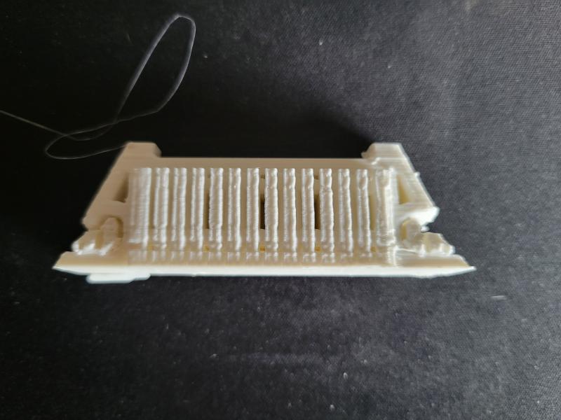

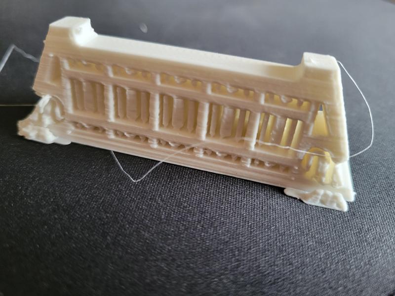

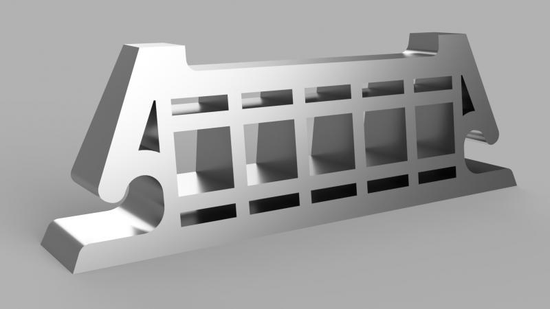

Curses, foiled again.....
I generated a 3rd version of my design to shorten and adjust a dimension. I simplified it a lot as I'm learning more about both the Fusion design tools and the printing process.
Good news, the library printed it fast.
Bad news, they printed unusable garbage.
Help me interpret this....
Did their software add a ridiculous amount of supports or was my STL file somehow "corrupted" or contained artifacts their "slicer" decided to print?
Here's an image of the STL file:
Here's what they printed:
I interpreted this mess as "supports" and asked them to print again with the "side" of the part against the build plate, as no supports should be needed.
I hope this fixes it but thought I'd ask as I have no visibility into what they are doing.

Your file looks fine, and I think you are right on the money, they didn't lay it flat on the bed so the slicer generated supports to fill the gap.
Also it appears their printer is totally fubarred, if that is PLA it should have printed out perfectly.
I'll PM you, email me the file and I'll print it, find out if it's you or them

I got a defensive reply from the library when I asked them to print it laying down.
I interpret this to mean they are just trying to help people learn a little but aren't committed to much beyond that.
I get it. The library is not a paid job shop and for all I know, some employee decided it was a good idea to print stuff, then quit and left other staffers hanging with barely enough knowledge to drag, drop, and hit a button.
All good, I got some prototypes that did what I needed and know I can design a simple part with some confidence.

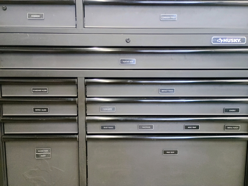

More 3d printing fun.
I got tired of NOT rearranging my tools where I wanted them because I didn't want to relabel the drawers. So I printed up a bunch of magnetic labels so I can move them whenever and wherever I want.
Also printed up hangers for my T-handle allen wrenches since no matter how hard I tried I could not find an efficient way to lay them out in a drawer.

Slick! Mikey likes it.
Are you printing "around" the magnets or gluing them into recessed pockets? Two-color prints or paint?

I had label maker mania for a while, loved them, still have two of them. But I found that either the labels didn't stick well enough, or they stuck too well and I had to stack them on top of each other when I wanted to relabel something.
Although, I'd pick up one of those in a heartbeat just for the date printing feature.
I'm gluing the magnets in pockets, but I have in the past also printed "around" the magnet, which is kind of a pain. You have to add a pause in the print after a few layers and after the magnet "pocket" is printed, then put the magnet in, then resume printing, which means you have to kind of stay and watch the print. Does make for a more neater looking piece, you do lose a bit of stiction. It's a bit more of an advanced process, you have to design the label properly (right depth pocket) and coordinate it with the printer layer depth settings so the magnet is at the perfect height to lay a layer on top of it. Also, not sure how the process would work with the commonly used hardened steel nozzles these days, I can picture the nozzle dragging the magnet around
I printed these in two colors.

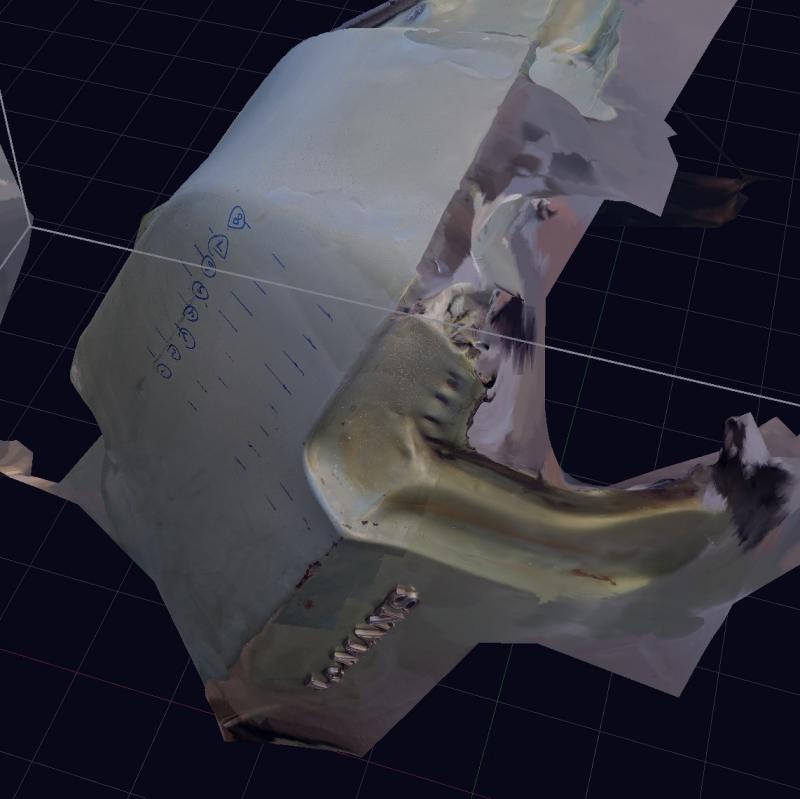

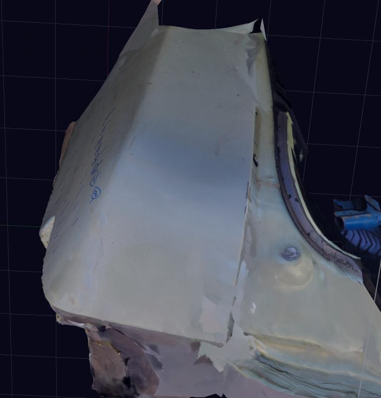

Rat-hole of the day.
Another car-related learning adventure... and it definitely could be used to generate models for printing.
I was thinking about how to generate some templates for body work and gave up trying to cut them from cardboard. I don't have the patience.
I won't buy a laser scanner or any other tool beyond a contour gauge but thought I'd try again to see what could be done for free using cell phone photos.
I went looking for photogrammetry software, thinking if I could generate a CAD model, I could maybe slice it and print sections to use as templates.
I ended up trying something called Zephyr 3DFlow that has a free version. I took a bunch of pictures (not enough), fed them to the software, and it generated a 3D mesh object. I can export to Fusion if I can get the size down... I may need to pull it into another tool like Blender to simplify for Fusion... don't know yet.
But this is cool! Takes the software a long time to process on my laptop (and it iterates painfully) but it did it. I will try again with more photos and taking more care with lighting. Might not be useful nor even accurate but it's a free way to digitize a 3D object.
These are just screen captures of the 3D mesh model. The lines are my marker scribes where I thought I'd try to cut templates before I canned that idea.

That's impressive for photogrammetry. I keep an eye on affordable scanner technology, still seems a bit clunky in the price range I would be shopping.

I do think the freebie photogrammetry software is more than capable but I haven't tried again... maybe it would help with your engine modeling. It takes a decent PC to run efficiently and mine is not it... I have an i9/16GB laptop but not really designed like a workstation.
