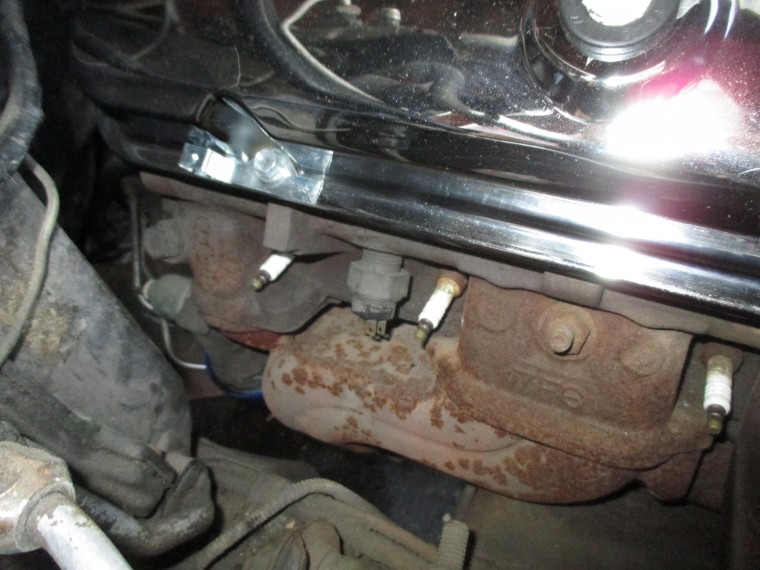

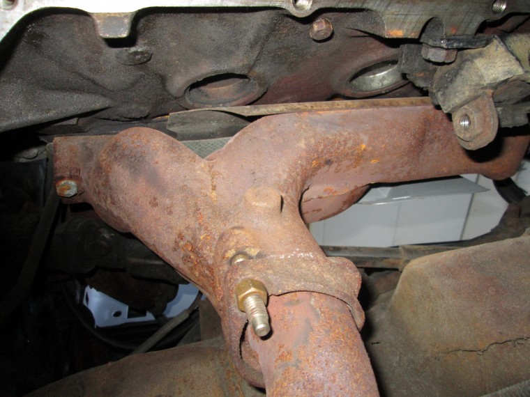

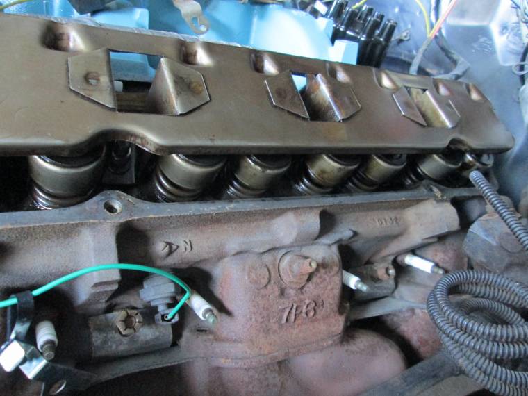

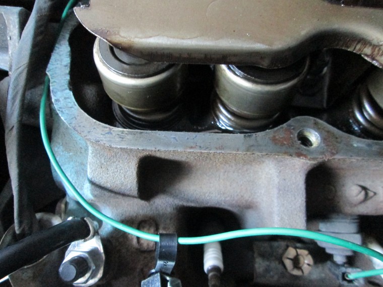

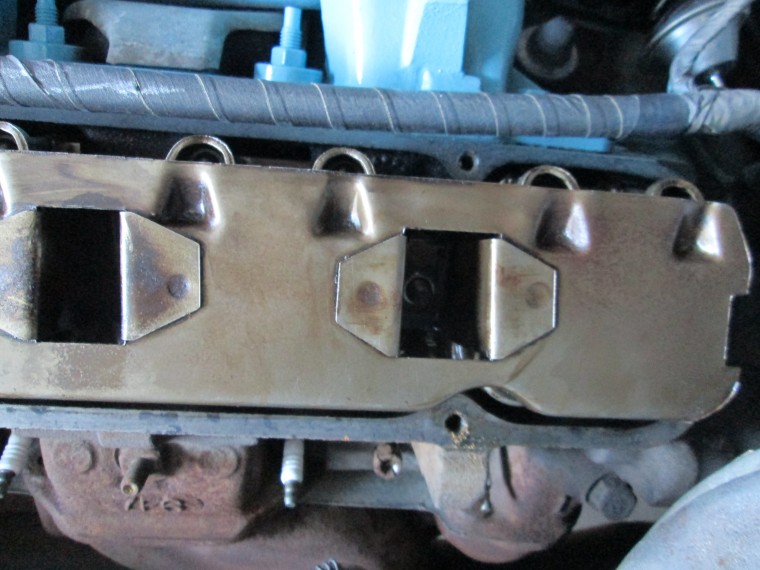

Default 1972 455 H.O. HEADS
if there are any engine experts out there please feel free to comment..as I now know I have a 1973 SR block, the heads remain a bit of a mystery to me...manufactured 5 months after the build date, yet 1 1/2 years old before the possible installation of the 1973 date coded SR block..were new heads shipped fully assembled?..these could have been off the shelf or possibly rebuilt?..are there any easy ways to tell?..are there any GM part#s to look for after removing the oil drip shield?...at 58k does anyone advise removing a head for visual inspection of the pistons?...the motor was running fine, preparing for the distributor change...obviously I want to Click image for larger version
Name:	455 H.O. HEAD DETAIL.jpg
Name:	455 H.O. ONLY OIL DRIP SHIELD.jpg
Name:	EXHAUST MANIFOLD.jpg
Name:	ORIGINAL RAM AIR EXHAUST MANIFOLD    ENGINE IS RAISED FOR PHOTO.jpg
ID:	352645do whats best and right for this motor to keep it that way...thanks!!!

If your motor was NOT leaking or burning oil,with even compression and no blow-by,I'd leave it intact.......the only thing to consider may be valve oil seals....which can be done without removing the heads.....
Opening it up will only create a 3-5000 dollar can of worms that may NOT need to be opened at this point in time....

Pontiac always sold their cylinder heads as bare castings only.

thanks!!..important that I know that..so I know I do not have the original heads..I have no idea whats involved in building a head..if they were new castings and new parts, which I hope..can a tech. at the dealership do this..or is this something that would need to be sent out?..thanks!...before this car ever sees highway miles, it will be checked & tuned to the max!!

Back in the '70's, a dealership tech would have been trained and the shop equipped to do the entire job.
Nowadays - no way. Everyone is too specialized for that. The cylinder head castings, valves, springs, etc. would be sent out to a machine shop for inspection, cleaning and assembly.
