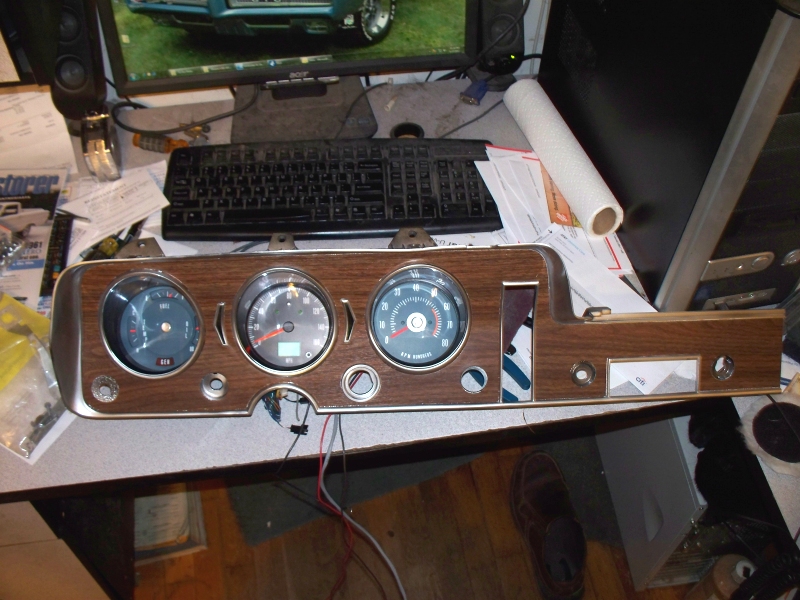

I did manage to work on the cluster a little each night. Getting closer to being able to install it.
The speedometer is a SpeedHut unit, uses VSS signal from PCM, has digital odometer and trip, can be calibrated separately from the PCM. It's still best to have the PCM read correctly though.
Tach is one of the aftermarket in dash replacements.
Gauges are aftermarket stock appearing replacement.
Oil pressure will read from a stock sending unit adapted to fit the metric fitting at the back of the block. PCM doesn't read the oil pressure.
Fuel gauge is feed from a stock type sending unit mounted in the Rick's gas tank.
Water temperature. I have yet to decide on how the solve this. There are several options.
1) OP amp circuit to convert a LS1 type sender to feed a 68 style gauge. There is a dual temperature sender available that one part would feed the PCM and the other feeds the gauge. In the original application, this would be a 2002 Camaro gauge. This is probably the easiest solution.
2) Custom BCM to read the OBDII signals and convert the PCM water temperature to a signal compatible with the 68 gauge. This solution adds the possibility of custom calibration to make the gauge positions actually mean something. Like calibrate it so that the gauge is in the middle position when the car is at normal operating temperature. There are single chip controllers and OBDII interface chips that make this solution fairly easy. However if I go this way I would program more functions in the computer. Functions such as delayed accessory power, control for the cornering lights. A small display could show any of the PCM parameters, speed, Tach, temp, O2 sensor, intake temperature and probably a dozen more. I think Painless is working on a similar gauge controller. It might be available by the time I need one.
3) I list this just to be complete, but I don't consider it to be very good. There is a plug in the back of the passenger side head. Some have stacked a series of adapters to allow the stock sending unit to be screwed in. The problem is the size of the stock sending unit. The sending unit will be located outside of the cylinder head and will not be in flowing water.
Of course it is possible to get an aftermarket gauge and sending unit that will work in the passenger head, but I wanted the stock gauge to work.
4) While I'm not considering this option, I list it for others. SpeedHut is about to release CAN Gauges. These Gauges connect to the OBDII diagnostic port, and reads out the PCM value. There are Gauges for speed, Tach, water, voltage, etc.

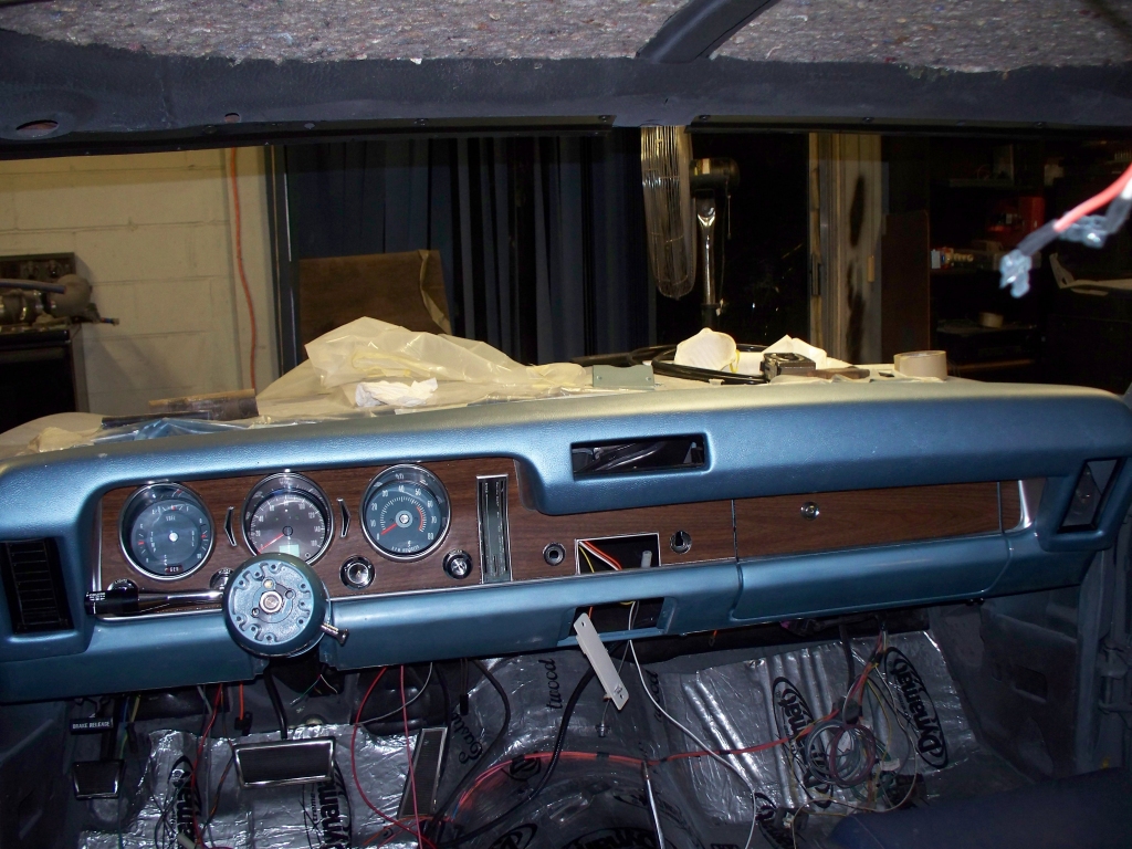

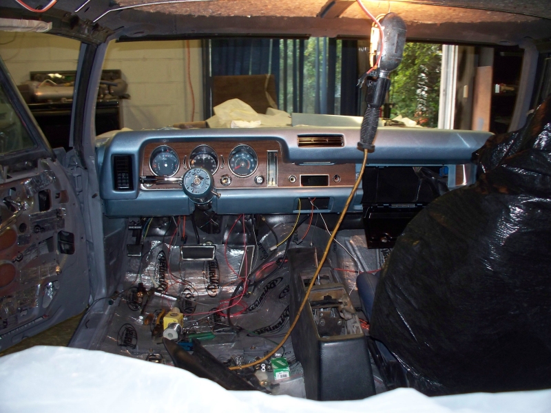

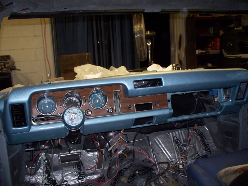

So installation of the instrument panel wins, so here is a work in progress picture.

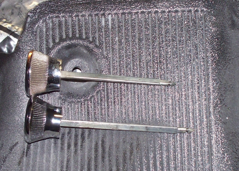

Current problems so far, reproduction headlight knob/shaft too long, reproduction cigarette lighter receptacle is made wrong. The dash pad is being a real pain. The studs that hold the AC vent deflectors at each end of the dash as not positioned correctly and the opening is slightly too small. The middle vent opening appears to be OK. I have managed to install the driver side vent so it looks good, but the passenger side will take a lot of work. The pad came from OPG and is not too good. It looked OK when I received it, but installing has proved to be a very difficult task. I wish I had sent my original pad to "Just Dashes".
Wiring is progressing slowly, but I am making progress. Part of slowness is due to the car being partially disassembled so I don't have pictures/notes of how it was wired. At least there are pictures/diagrams in the service manual. The wiring harness I am installing came for American Autowire.
I hope someone makes a correct length headlight knob. My original is missing chrome on the front.

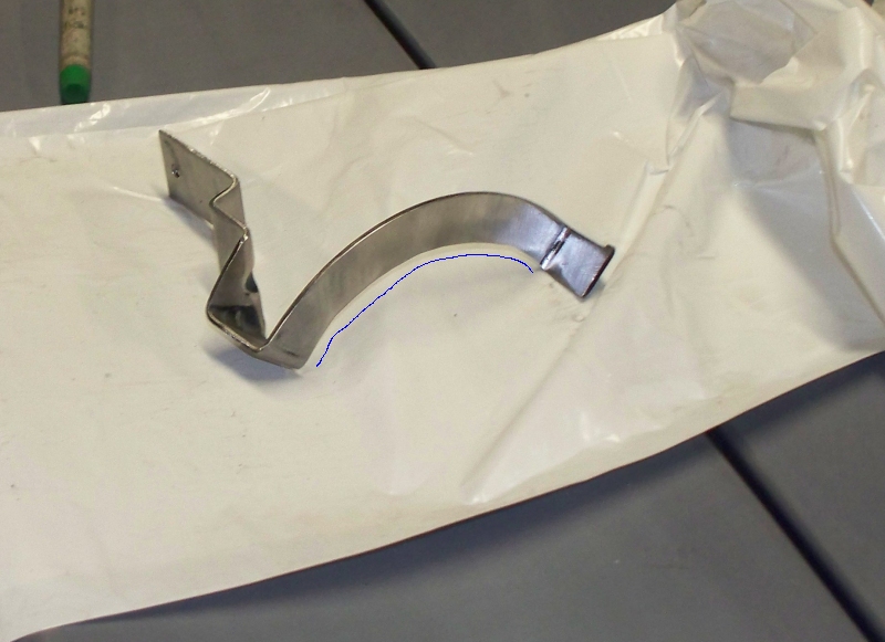

Problems with the cigarette lighter. This is original, the connection point gets fatter along the pink line, this is where contact is made by the wiring harness. The reproduction unit I have has the same diameter (green line) along the entire length. I didn't discover this until attempting to connect the power lead to it.

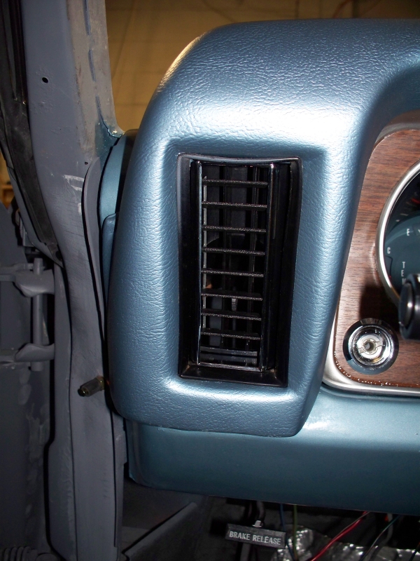

Driver side vent installed turned out good. I had to carve foam out from around the opening to make the vent deflector fit the opening, the studs that hold the deflector in were only off about 3/16" on this side. On the passenger side, the studs are at least 3/4" out of position.

Cigarette lighter problem resolved. When I managed to get my head up inside the dash I was able to see that the power connection shaft did have a fat part, but it was very short, maybe about 1/4 of the length of the OEM part. It was also larger and the transition from the small to the fat was not tapered like the OEM part. By cutting the thin part of the power connection shaft so that is was much shorter, it was possible to get the power connector to reach the fat part of the shaft. The connector still wouldn't push in due to the fat part being larger in diameter. By cutting the plastic insulator off and spreading the connector out a little it was possible to install the connector. I used some heat shrink tubing to insulate the power connection.
While I don't care for the cigarette lighter to function, I do want to be able to charge cell phones, cameras and other electronic devices.

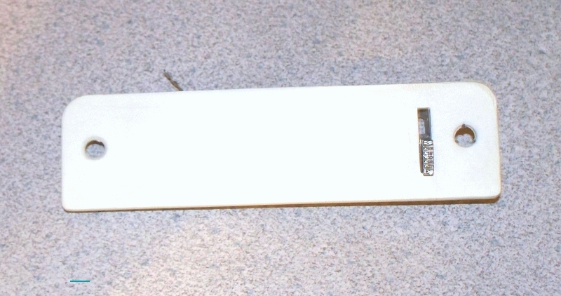

Since it doesn't look like the courtesy light has been reproduced, I spent some time cleaning up and polishing the plastic part. Originally this part was yellow and very dirty. Sorry the before picture was too blurred to post. While I'm not a big fan of LED lights, I think I will convert to courtesy light to LED. The heat of the bulb has already cracked a piece of the plastic. I'm also planning to use a LED light in the dome light, the incandescent light melted the original housing and dis-colored the cover.
Also got a few more wires connected in the dash, put a little more of the dash together. I should be able to do some testing with power applied in another day or two.

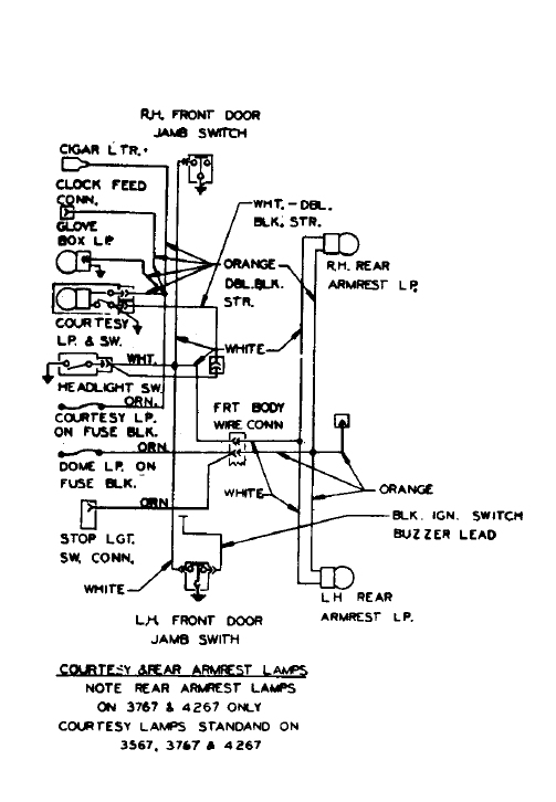

From what I can find out the drawing below is what should connect to the light.
I don't have any White/Black stripe wires in either the old harness or the new. There was no wire connected when I got the car. The White/black wire connection could be spliced in to the wire that connects to the passenger door light switch. The passenger door light wire should be close by. (White).
I don't know how the metal tab was grounded by the factory. I can't believe that the metal core in the dash pad would be a good ground. I'm simply going to attach a clip to the back of the screw and ground it since I don't know how the factory did it and can't find any drawings.
A yellow wire near the radio opening would be power for the radio.

It looks to me like the courtesy light should light for the following conditions.
1) either or both doors open
2) the headlight switch rotated to the extreme left.
3) the switch on the courtesy light activated.
It also appears that the dome light would come on anytime the courtesy light is on.
This is based on my studies of the diagrams and schematics. I have already concluded that the schematics don't exactly match to car and can be only a guide at best.
Here is the drawing of the instrument panel in case it helps.
If you add a wire that I show as a green line, you should get it working.
If you want the switch to work, you must connect a ground the metal tab that the screw hole passes through.
I think that prong is not used.
Mine car had a connector plugged into it at one time.

If you look at the drawing above the black wire coming out of the courtesy light makes its way back to a connector near the head light switch. The RH door jam switch also makes it back to the head light switch. I'm baffled as to how this wire was run in my car since neither the OEM harness or the Autowire harness has such a connector. However the splicing into the RH door jam wire would had the same effect.
The White with Black stripe color that I listed came from another post. I was unable to find any reference to the color of the wire in any of my documentation.
BTW the wiring in my car was really messed up, wires cut, spliced etc, it looked like a rats nest, so that fact that parts of the wiring is missing is not surprising.

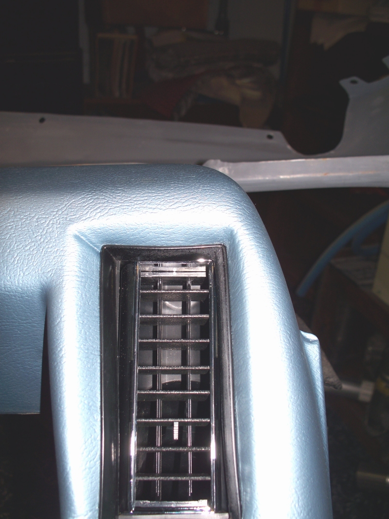

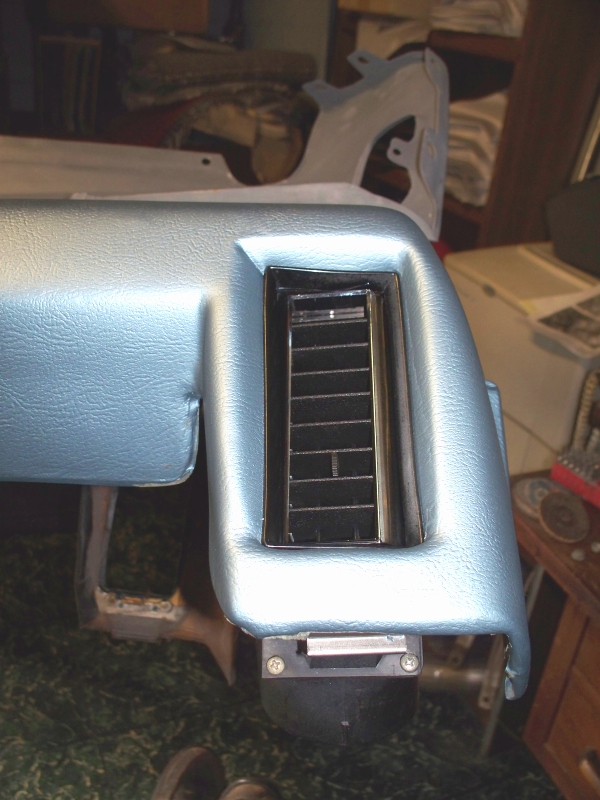

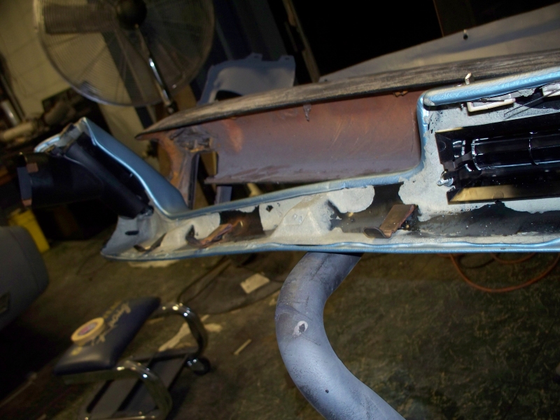

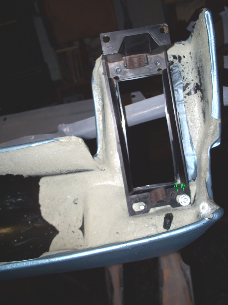

I worked on the nightmare dash pad today. Lots of work, not sure if there was a better way, but interior trim is not my strong point.
The trim ring slips in and then part of the air vent get fashioned to the studs on one end and screwed into the dash on the other. Not even close to aligning. The green arrows show how much farther it needs to go and the slot is out of adjustment.
This is a mock up as it is. Vent can't even be adjusted.
I had to carve away the foam as well as lengthen the slots in the dash vent retainer.
Not centered perfect but much better. This is as good as it gets without moving the mounting studs, which is beyond my ability.
The vent is likely to point toward the passenger anyway, so the alignment problem is even less noticeable.

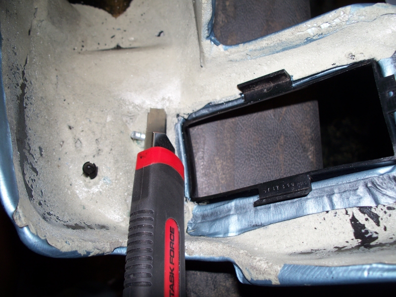

This guy was painful to install, the cutout was not marked properly and took a lot of cutting and trimming to get it to fit well.

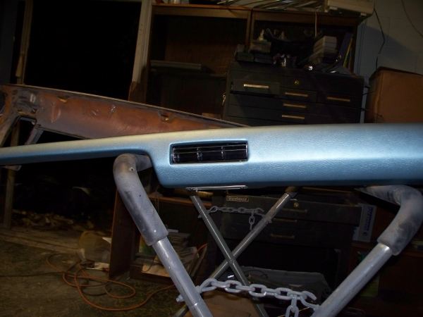

Cut slots in the pad for the metal retaining clips. Since the pad is foam and plastic, these clips are not retained too good, but will work.
It appears that will all the clips installed and with screws installed, the pad will stay in place and will look good, but is not nearly as secure as the factory pad.
It appears that the dash pad sold by OPG is not the same one sold by Performance Years and AMES. The PY/AMES listing talks about a fiberglass core. This dash is simply foam pressed between two thick sheets of stiff plastic that was molded into shape.

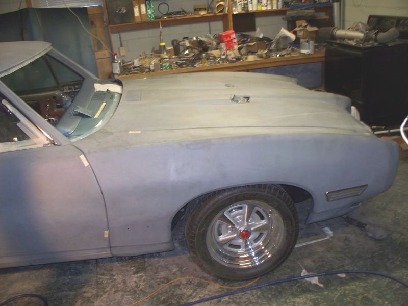

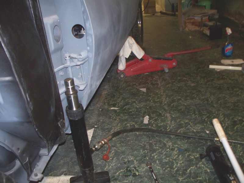

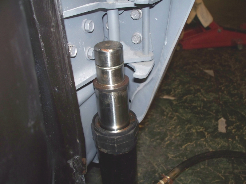

Drivers door needed a final adjustment. It was being supported by the striker plate when I aligned it months ago. The only problem is the door droops when open. The door needs to be located properly without the striker plate when adjusting it, but working alone I used the striker plate to support the back end of the door. Ideally you need two or three people to adjust the door but I came up with a solution.
I used a body jack at the front and a floor jack at the back edge. The rear of the door should be placed about 1/2" higher than where it needs to be. When you tighten the hinge bolts and release the door it should fall about where it should go.
The body jack fits against the hinge really well. Fine adjustment is really easy with the body jack.
Of course adjusting the door meant that the fender had to come off, so I ended up bolting everything back on and doing one final alignment. That is fender, hood, bumper, valence. Just to make sure that everything will still line up. While the fender was off, I made the hole in the core support for the cornering light slight bigger. It lightly touched the cornering light housing.
Everything looks good. I didn't do a perfect alignment, just close enough to make sure everything can be aligned. I also measured and recorded all of the gaps.

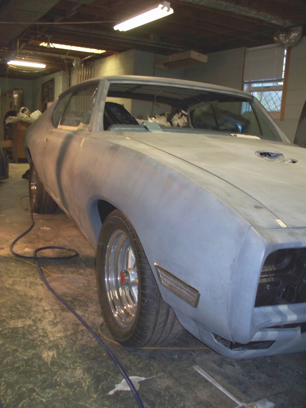

This picture shows why you need to wear gloves after getting ready for paint. All the discoloration is oil from my hands and arms while I was adjusting the fender. OF course the was already dirty from my flood and basement clean out.
Unfortunately the car comes apart again so I can paint the jams.
