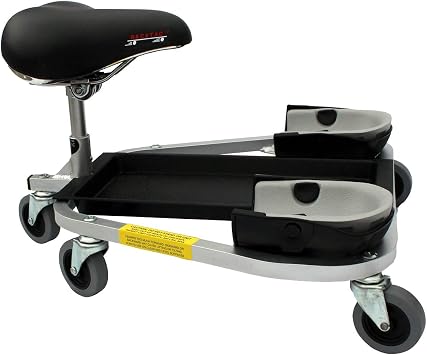

So for the second time, I aggravated the sacroiliac in my lower back. This time I took over a week off from working on the car. And during this time I bought a special kind of creeper seat that was designed for this issue. Funny looking contraption:
Tried it out the last couple of days for short durations and it does seem to work. My back has continued to improve.

Wow...nice work.
Hope your back returns to normal quickly...interesting creeper.
Thanks!
The creeper is helping. Glad I bought it.
