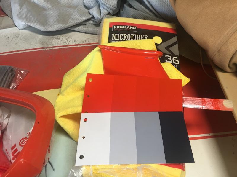

Had to decide on the color of the underlying primer sealer...surprising what a difference it makes...that's 4 coats of high quality base coat (PPG) carousel red on that card. Also very surprised by how much a gallon of paint costs these days.

Wow... I would never have guessed there'd be that much variation in color with 4 coats applied.
