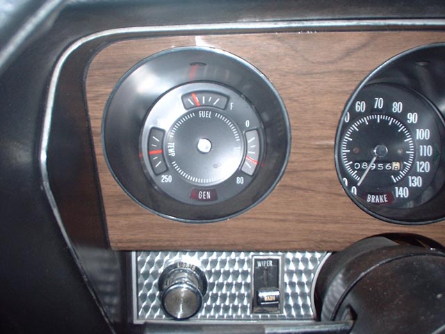

Ok, the results are in kind of. I say kind of because it is kind of cool outside today, although it seemed my car would get hot no matter what before anyways. I took it for about a 15 minute drive after letting it idle for about 5 mins and the needle went up to about the half way mark which I assume to be 175 at the midway point so it was about 170-180 degrees,and held there while idling for about another 5 mins after I got back. and I am currently running with a gutted out t-stat. So if it were me, I wouldn't put in those pumps with the shorter vanes on them. I would return them and drop 16 bucks at autozone, and it isn't even a special order item...on the shelf just my opinion. One more thing, after parking I popped the hood and grabbed my hoses and they were merely luke warm, Before they would damn near scald my fingers if I were to try that! I hope this info has helped you guys!

  #262
Old 05-02-2004, 04:26 PM
Old Goat 67's Avatar
Posts: 6,720
Is that sweet picture or WHAT?

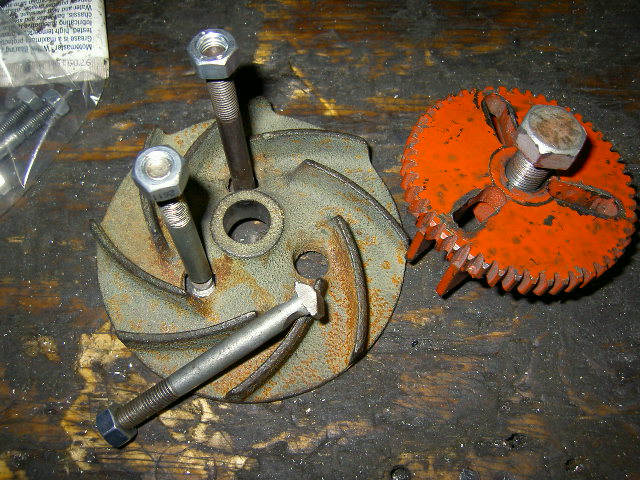

Grandville,
You could pull the good impeller off your old pump if you have the three balance holes. I made up a puller and got the impeller off a '73 pump and a '68 pump quite easily. The bolts in the photo are 5/16" with the heads ground to a T shape so they can be finagled into the balance holes. I clamped the pump in a vice with the impeller up, poured water in around the seal, and heated the impeller hub. The water stops the seal frying.
Malcolm

  #274
Old 05-05-2004, 08:10 PM
grandville455's Avatar
Posts: 10,862
Thanks Malcolm I'll keep that in mind,But i am persistant and will find the one I need ,lol

Wouldn't malky idea work to just pull the impeller a little closer to the divider plate? Rather than beating it into compliance.

I'd say it would work and the spacing of the impeller on the shaft is probably one of the reasons for the poor fits we are seeing. In some cases we have seen, the OEM impeller vanes are higher and give the best fit. Beating on the divider plate is easy to do, tho. Everyone has a BFH, even tho one doesn't need the Big one to do the job.
