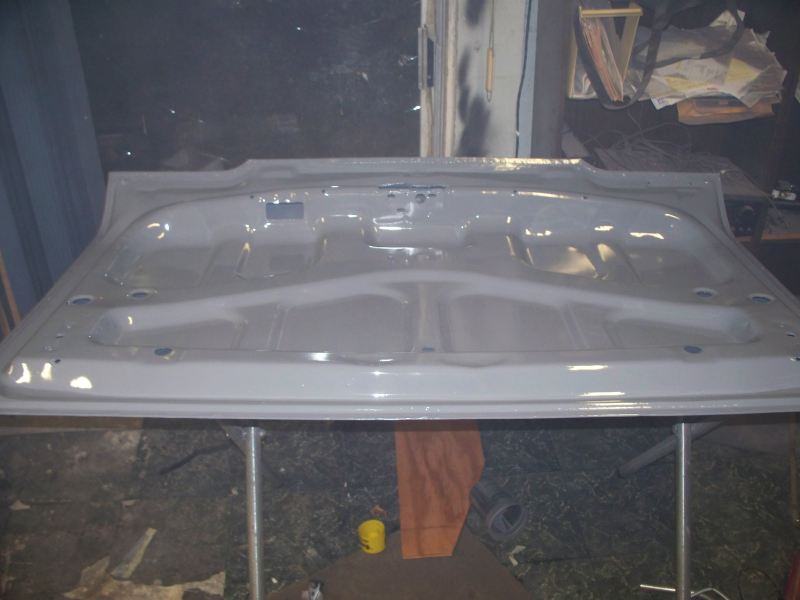

I Primed the trunk opening area today.
Masked and ready for primer.
Primed
Under side of trunk lid ready for primer
Primed
Next will be to install the trunk lid and do the final prep work to the trunk lid.

Not sure all the expense and work was worth it, but it is cool to see them work when I hit the turn signals at night.
That's going to be one really nice car. Looks to me like the final results when you are fixing gap and alignment issues are better than the factory standards back then.
