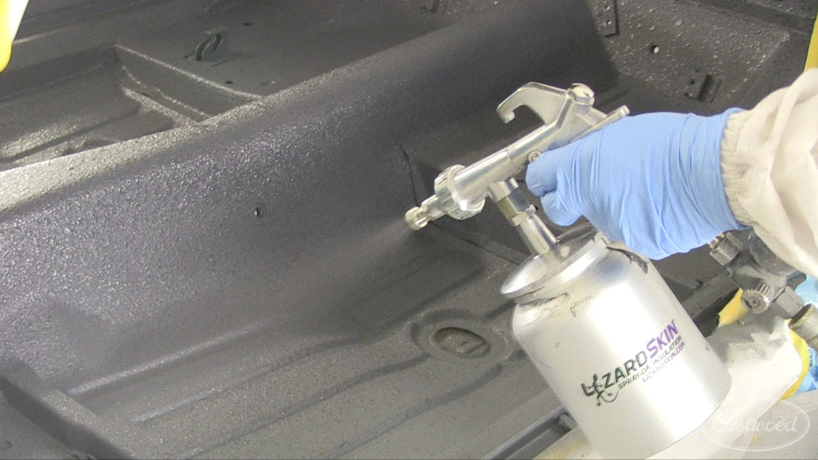

There are 2 Lizard Skin products and i'll be doing the ceramic thermal barrier (http://www.carbuilders.com.au/lizard...mic-insulation) followed by the Lizard Skin Sound Control (http://www.carbuilders.com.au/lizard-skin-sound-control) because the trunk of my car has more surface area than all of New York city's airports put together, and the new, flat trunk floor is probably going to drum like the ghost of John Bonham (aka a thundering bastard).
Lizard Skin ceramic thermal liner:
Lizard Skin sound control:
Acoustically my car isn't as bad as this van, but I want to knock as much crappy NVH out of it as possible.
https://www.youtube.com/watch?v=W6XG1InN_h8
Once the Lizard Skin coats are done I'm then going to top coat the underside and inside of the trunk in Bully Liner, as this will further help NVH as well as being a nice hard-wearing surface. So the spare wheel, tools and other items* floating around won't scratch the bejeesus out of my nice new trunk floor.
Bully Liner is like this, but bleck.
It's good stuff -
https://www.youtube.com/watch?v=5DvsrTSG3EI
I'll also be doing the 2-stage Lizard Skin straight onto the inside of the roof/turret, and then I'm also going to order up another box of the Car Builders peel-and-stick Black Label sound deadener (http://www.carbuilders.com.au/sound-...-1-black-label) to go over the top as a few friends have had huge success eliminating noise (particularly drumming) and heat this way. I've already done the Black Label insulation on the floors and doors and it is A) a damn sight cheaper than Dynamat and B.) it is an easier product to work with. Brendan Carroll who runs Car Builders actually works for Holden doing insulation and acoustic work and this is all manufacturer OE-level gear.
