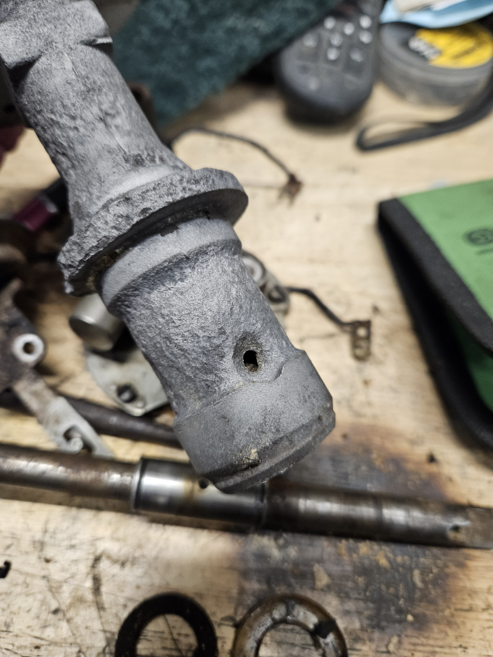

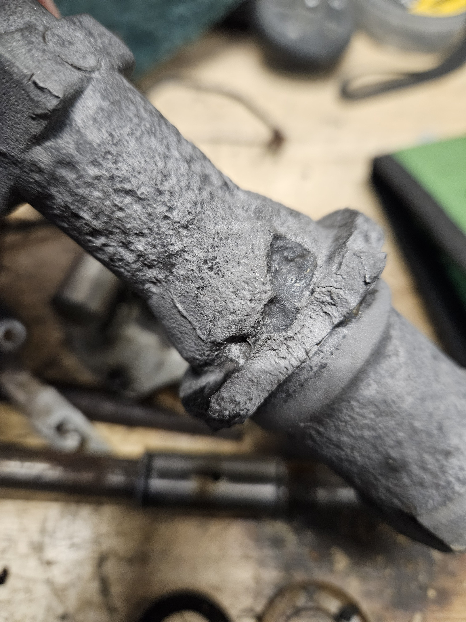

The poor distributor was weak enough that it developed a hole during the latest round of cleaning. Unfortunately, I think she's cooked. Should be fun finding another with an acceptable build date.

A little JB here and there , repaint with cast aluminum below the ID rim.
Easier than the pits in the axle housing to repair.
Or , spend the 4 figures on a replacement.
Or , other variable alternatives
It is pretty compromised though.
I'd start with seeing if it's still snug in the block bore before getting too friendly with it.

I'll give it a shot. I guess it's worth it before tracking down another. I just need it to hold itself together when banging gears!
Does the stamp number 1112024 or 1112034?
Does look like 1112034 , instead of 2024
1970 W30 442 Olds ?
Or a 1980 built Service Replacement for 71-72 W30 442
idunno
  #267
Old 04-21-2025, 08:28 PM
This is funky
Olds rotates CW
Pontiac CCW
It's 1112024. It does kinda look like a 3 in the pics, but it's definitely a 2.

There are plenty of good 1970 cores, get one restamped, and the original.. dunno, it's not wall art, looks like it was in the Merrimac.
It does haha
I'll be on the lookout for a 70 core.

I think I have a late March Dist from a L65 XX here, and a may have one from a May L74 YZ. I will look in the next day, I have others wanting things.
