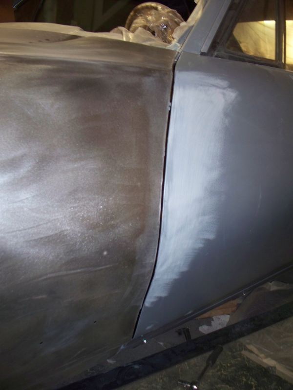

Not much new going on still working problem areas. However the passenger door to quarter filling is totally complete.
I thought I would outline the steps I followed since this is a little different from filling a slight depression. I find it is much harder to build up a surface as opposed to filling in a dent. For the first two to three filling sessions I tape up the quarter and jam area since I don't want any filler on the quarter. I use quarter panel as a guide, dragging one edge of the spreader across the quarter panel to set the contour on the door. In my case I took three attempts to get the level built up high enough. For these filling sessions I used regular Rage. I kept the door edge square and waited until everything was finished before rounding the edge slightly. For the Last coat I used Rage Extreme. For this last filling I opened the door at applied a light coating dragging the spreader fairly hard since I only wanted a thin coating for the last coat. After sanding the filler fairly smooth I applied a guide coat and continued sanding until all of the guide coat disappeared. My last sanding was done with 320 grit to feather the edges.
This is the end result. I am showing this in slightly higher resolution to give a better view of the result. A few comments since photos often lie and things aren't as the appear in the photo.
1 - The result is extremely smooth and no ripples can be felt with you hand. The dark spot at the very top is where I sanded through the Rage Extreme and uncovered Regular Rage which is a slightly different color.
2- The two blue spots are where I fixed a couple of pin hole problems. For this I used Easy Sand, which is a spot filler.
3 - Because of shadows and the slight sanding on the edge of the quarter the gap looks uneven. It's much better than it appears in the photo.

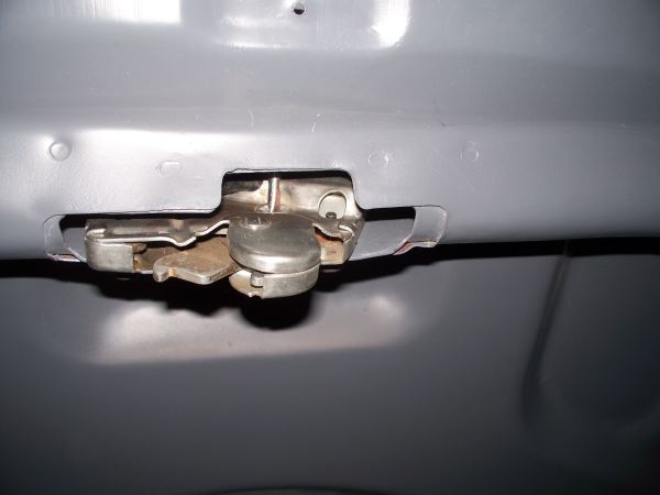

I have reinstalled the trunk lid so I can make the edges flush. The back edge varies form being flush to being depressed by about 1/16". I applied several coats of Rage to build the edge even.
The edge is nice and flush now.
This is still a work in progress. I still need to sand entire lid smooth and apply a very thin final coat of Rage Extreme over the entire deck lid, followed by one final sanding.

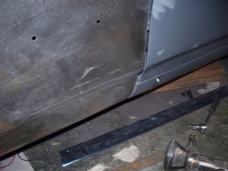

I started on the driver door to fender gap problems. My original alignment compromised the gap at the top of the door to get the panel alignment better in the middle. Since I going to use filler to address the middle of the door problem, I readjusted the door so than the alignment was flush at the top of the door. This made the gap much better, however the middle of the door is now depressed by about 1/16 instead of 1/32".

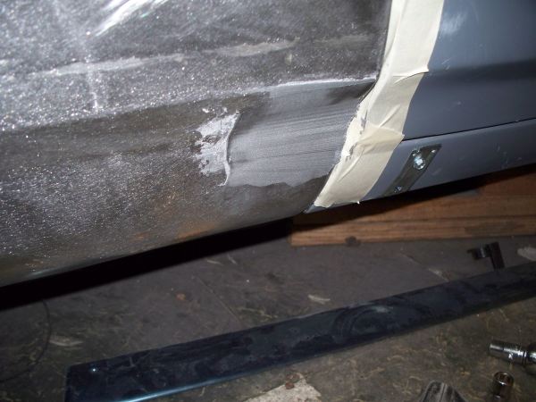

The bottom of the door however is still bad. The contour on the fender patch simply does not match the door.
Since this requires around 3/16" of filling at the deepest point, I'm using "All Metal" to do the initial filling.
This is the first coat.
I used a total of three coats to get to this point. This is close enough to do the final filler work with Rage Extreme.

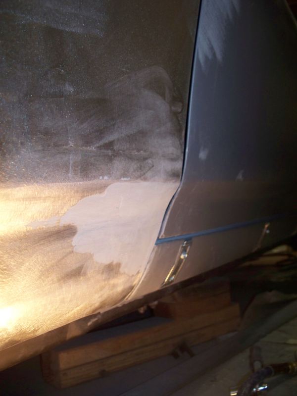

Driver fender, almost finished here. Covered the weld seam where the lower fender patch was welded. Also covered the "All Metal" where the contour was off. Also I didn't bring the filler down far enough on the driver door. Sanding produced this sharp edge. I should have brought the filler down another couple of inches.
For comparison this is the before of the door to fender contour problem.
Door edge is almost finished. I brought the filler down a little farther.

Here is a close up to the build up bumper edge. The contour of the bumper did not match the fender at the top. I used 3M 5895 Plastic Repair. Most of the products listed in older Bumper refinishing articles are no longer available so I picked this as the one I thought was best of the available products. A week or so after I started the repair Paul@Fast listed this as the product he uses so it should be good product for the purpose.
Sort of mocked up for test fit purposes.
In between waiting for filler to dry and when I only had a few spare minutes, I worked on the trunk. Dynamat not completely installed but getting there.
