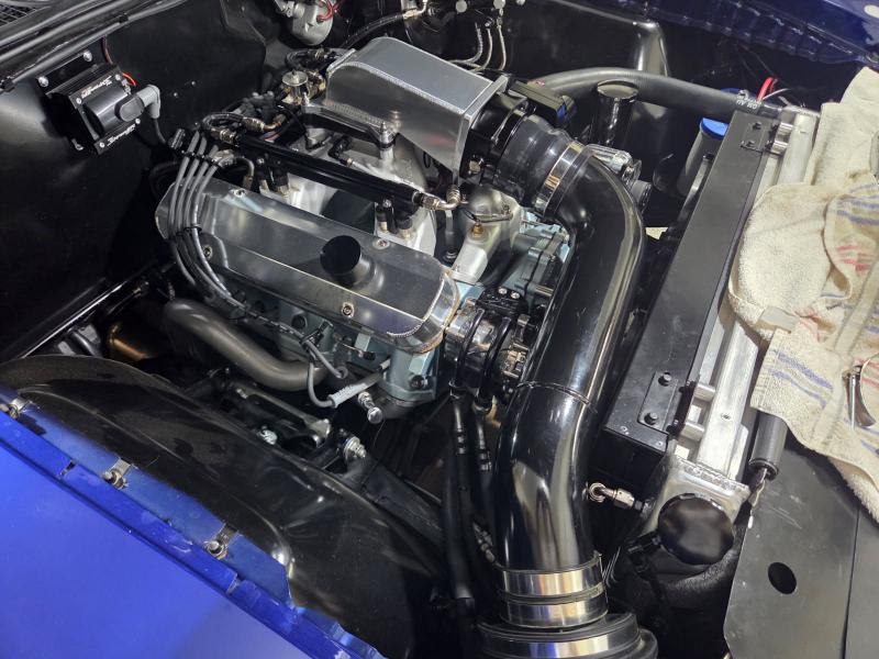

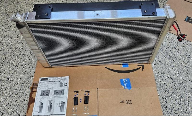

Finally got around to installing my Cold Case radiator, and found my new fans for it too. (Still not totally unpacked from move). Need some fittings and a couple other small items to finish it off.
Selling the eBay 4 core radiator and the fans, if any are interested, it's in the for sale section for a while before I list on eBay:

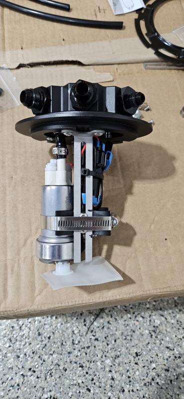

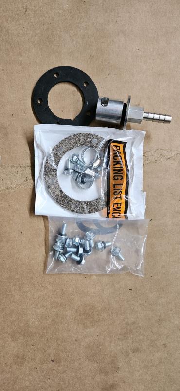

Rick's tank came in, am almost done with the install. I also rewired the pump circuit to include 10ga wires, and a relays for each.
I did the wiring upgrade before the tank came in, and, low and behold, discovered a failing relay. Since I had added a relay for the new tank/pump assembly, I figured I would add a 2nd relay so if I wanted I could add a 2nd pump as a backup if the primary pump failed.
In the process of completion, I must have swapped the relays around for the primary & secondary pump, and the falling flat at WOT was completely gone. Uhg. Appears to only occur after some time running, and during a WOT pass of more than 3-4 seconds. I guess the relay was clipping out under load or something, but glad I found out!
Still going to put the Rick's tank in though, can't send it back anyway.
The wiring I did uses an 8ga feed wire that splits into 2 10ga wires to power the relays, and has a 60a maxifuse (on the 8ga). The pump hat harness that comes with the pump hat uses 10ga wires, which go to the relays. I'm using the 70a relays that have the larger tabs on them.
