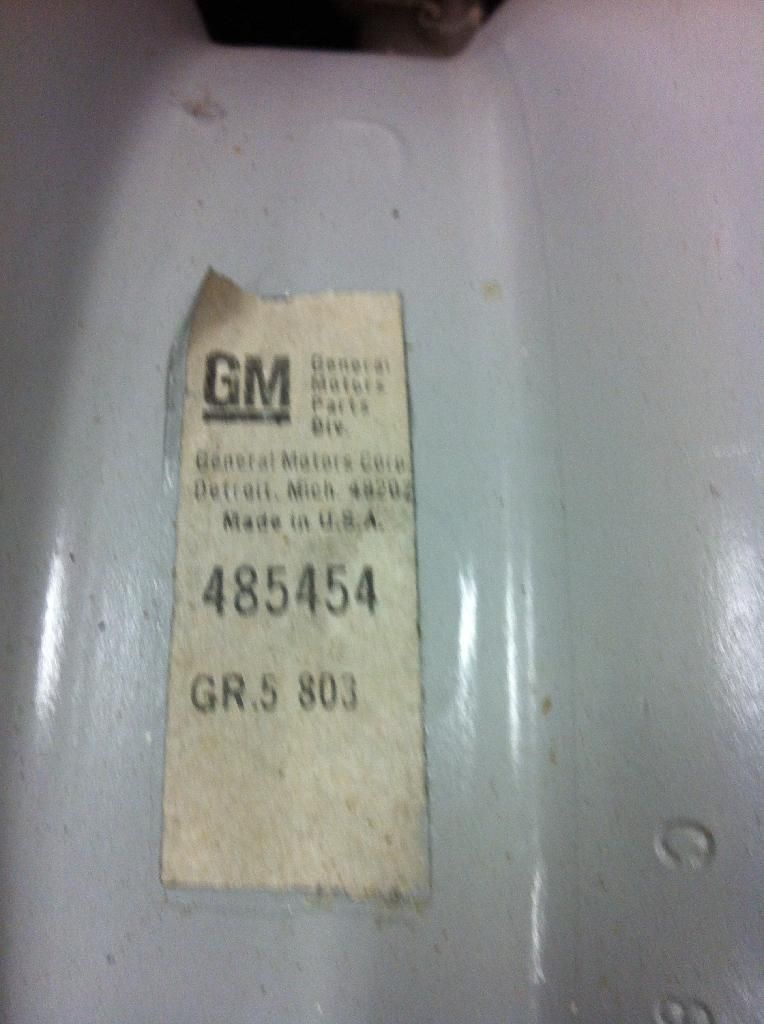

While waiting for parts, I started blasting the rims. They're in incredible shape, especially being on a New England car their whole life. Very very minor pitting in a few spots that will probably fill in with primer alone, but I'll bodywork them slightly.
I grabbed a few pics of the stamps found on the wheels if anyone needs them for reference.
