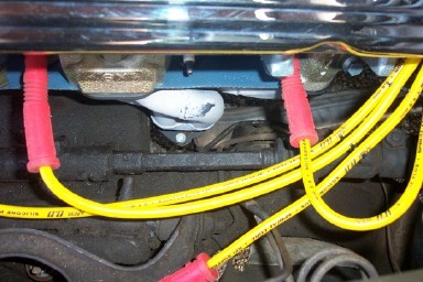

Old 07-06-2003, 08:34 PM
grandville455's Avatar
Posts: 10,862
0h ok heres the one you were waiting for its posted somewhere else too .lol
Grandville464
