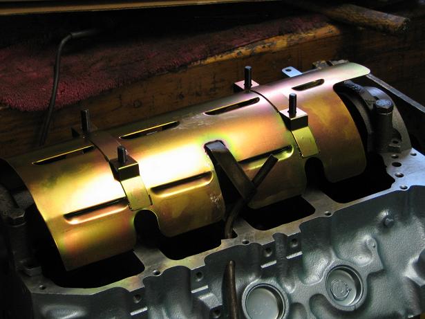

I just bought one of the milidon windage trays and it does not work because the studs are too long to allow the stock pan to button up.Basically the bottom of the pasn becomes the windage tray on the front anyway soo....
