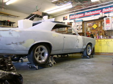

My 67 GTO is under construction. I have BFG's g-force KDWS's 255/50 x 17 on the rear and 245/45 x 17 up front mounted on American RacingTorq Thrust Original 17/8 4.5 BS and 0 offset. It appears that the fronts will work fine but the rears hit on the outer wheel well. If I want to use the rear set up I will have to narrow the rear end by about 1 inch on each side. I do like the looks of the combination.

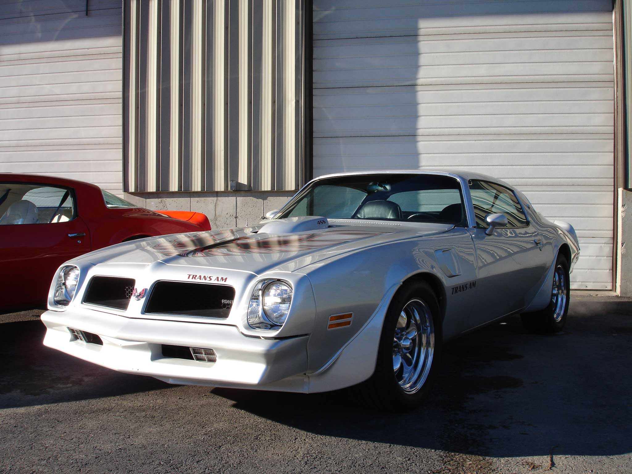

76 T/A lowered 1.5" front and rear with the Competition Spring Kit from Pro-Touring F-Body. Wheels are American Racing's Torque Thrust II's at 17x8 and 4.75" back spacing all the way around. Tires are BFG g-force KDWS's at 255/50/17's all the way around. Nothing rubs anywhere under any circumstances. No modifications were required.

I must have let this go too long as I can't figure out how to modify my orginial post. I have 17x8 Troq-Thrusts with 4.5" backspacing and 0" offset front and rear. I have 245/45/17s in the front and 255/50/17 in the rear. To get the 255/50/17's to fit in the rear I narrowed the rear 1" on each side. The car in the pricture has the original rear springs installed. I want the front 1 to 2 inches lower, then I'll lower the rear end. The car has disks front and rear along with 2" dropped spindles and 1" dropped springs up front I think that the dropped springs are too stiff as it doesn't appear that the front dropped much at all and I don't like the way the wheeling tire fit in the wheel well.

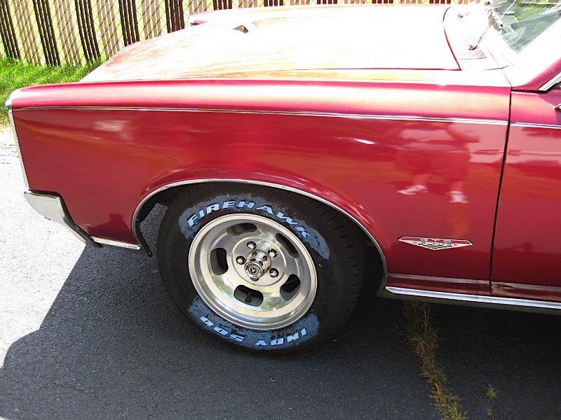

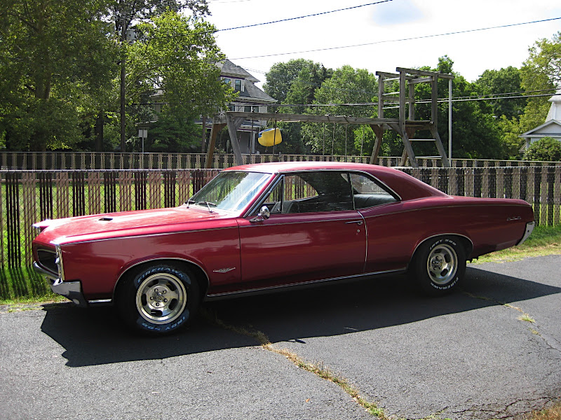

Tire: Firestone Firehawk Indy 500
225/70r15 back
215/65r15 front
Wheel: American Racing Ansen Sprint 15x7
The front tires rub a little on the outer fender lip during turns, with stock suspension. Soon I should be upgrading suspension and I'll see how it goes.
