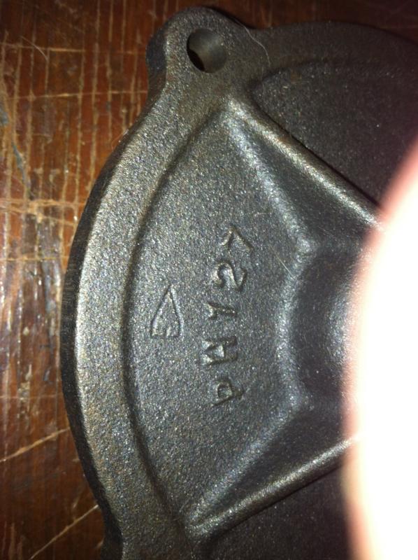

This water pump came off of a '63 421. Notice it only has 3 gussets that extend from the base to the hub. This one fits a '63 389. The part number ends in 677, the rest is hard to read. Didn't see one like this in all of the picture travels. Can someone measure the distance on ones that we agree will work on a V8 from the back of the cast base (that touches the timing cover) to the front edge of the hub? It should be 2 7/8" or 3"

One of the first things I noticed is the bolt holes are all the same. The typical water pump has one bolt hole that's different than the rest. There's one outside edge that's sort of squared off that your's doesn't have. I wonder what the deal is with that. That part number doesn't show in the list pfilean put up either. Hmmm....

BigAuqua, that pump looks like an aftermarket casting.

I think you're right about it being aftermarket. I've not seen another like it. I found one that I hope works on EBay for $60. It has the andromeda/swirling star pattern. Hope it works.

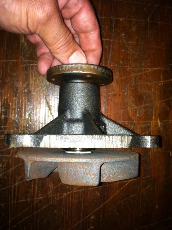

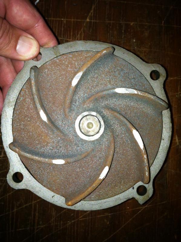

This is the one that I purchased. Hope it has the deep impeller.

Oh, Mike (BAB), that pump has the right stuff as for impeller vanes!
Attachment 296974
Attachment 296975
Attachment 296976
That does look to be the correct pump!!!

This is a beautiful thing that you have told me. Typically, I end up buying 2 or 3 or 4 of whatever before I get it right. I appreciate your help with this, A LOT.
