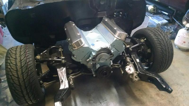

Engine and trans installed, going to the body shop this coming week. Sweet. I missed my slot because the engine took a while, machinist had the flu, was a nasty one, glad he cleared that ok.
Finally got to use the G-Force 4L80E swap trans cross member, had that thing for probably 2 years, never installed it. Fits great, and allows for a certain amount of adjustment at the mount, up and down, with shims, to correct driveline alignment. Will get to use my Tremec app on my smart phone for that.
Once it's in the body shop I will clean the garage, ebay a bunch of parts, and get the front & rear seats recovered. I can knock that out in the basement, won't freeze!

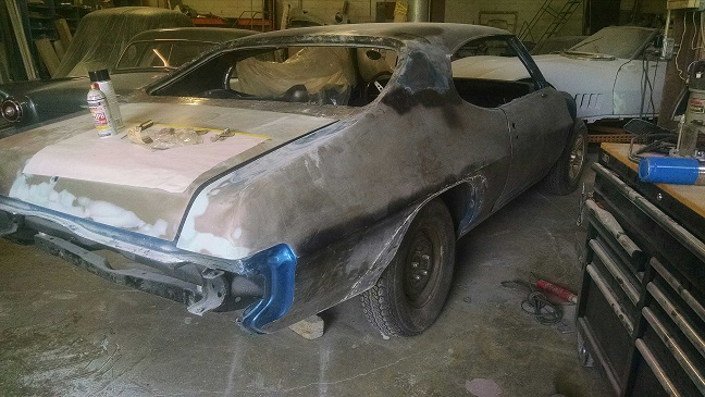

Stripped, can see the previous work that was done, thankfully it wasn't as bad as I thought it would be. I was sweating they made a mess of the whole panel, this can be done with a patch.
Can see some of the work already done on the trunk lid and quarter end, they are trying to keep busy until the quarter patch panels come in.
Roof was saved from a good coat of POR-15 like 15 years ago, no major work needs to be done anywhere. One door has a small spot in the lower rear corner where previous repair work needs to be corrected, nothing big.
Some minor window channel work as usual, again, nothing big.
Another 2 - 3 weeks and it will be further along, I will go up and grab some more shots then...
