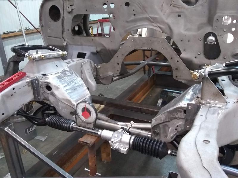

Default Engine X-member and steering
Finished off the cuts in the sub frame and added 1 5/8" and 1 1/4" 4130 tubes back in. Started to mock up the rack and pinion. As soon as we finalize the rack's position we are going to add 3/4" tubular gussets from the plate to the larger tube. We're going to need to put the mock up engine back in to determine if the balancer with the trigger wheel on it are going to be an interference issue with the rack. More to come...

Some work on the front motor plate so we can mock the engine back up for rack clearance. (Looks like we'll have to cut off the v-band flange off of the LH manifold and extend the log through the plate and reattach the v-band flange.) Then rack and pinion final welding.

Default More Progress
Rack mounting finalized. (crappy hose clamp on the rack is temporary. There is a really nice band clamp that goes there, just easier to take the hose clamp on and off ) Mock up of steering shaft also.

Very nice!! Are you going to be able to get the band clamp on the driver side header?
No, we are going to cut off the v-band flange and extend the log.
