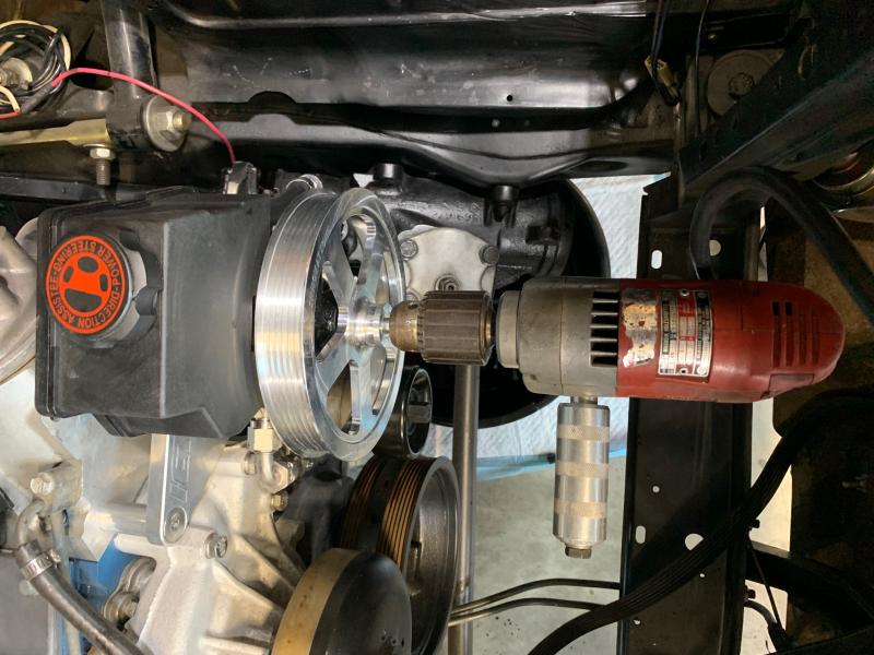

I chipped the first POS plastic pulley when I was tightening the pressure hose. Barely bumped it. Had to cut it off. Puller ripped the flange off and it still wouldn't budge. Bought a new one. It wouldn't press on. It seized up just short of going on all the way. Ugh! I bought a billet pullet this time, Put the pump in the freezer overnight. Put the pulley in boiling water. Greased the shaft real good. Went on like butter! School of hard knocks in session again.
Then I decided to test the system before firing the engine. Cut the head off of a bolt and used a drill to spin it. Works perfectly! No leaks. Turn the input shaft by hand since the steering column is out. Lock to lock smooth as glass.

The pump pulley is meant to be a dry interference fit to keep it on the shaft. Using grease on the shaft is questionable. The pulley may come off easy as "butter" too. JMO

I'll have to disagree with ya on that one. A proper press fit isn't going to come apart because lubrication was used to assemble it. The lube just ensures that the metal doesn't gall and seize up. But I also added a retaining bolt with lock washer and blue Loctite. I guess, even though I disagreed with ya, I was a little concerned. Lol!

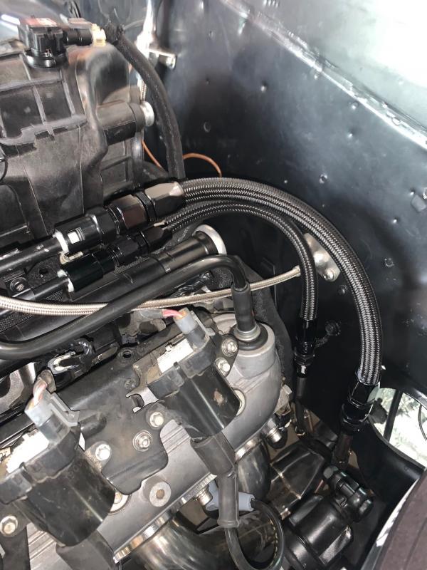

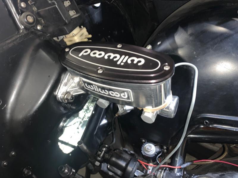

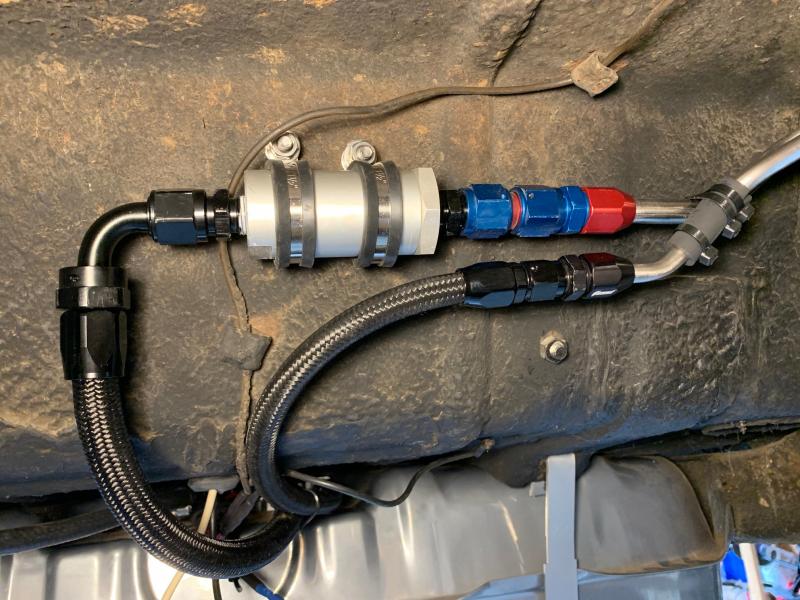

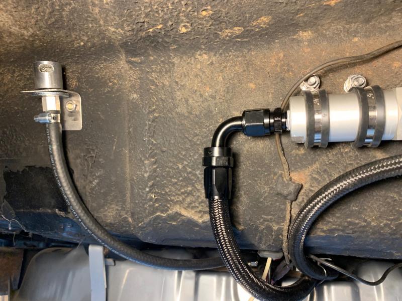

Made some more progress. Fuel lines are done. I pressure tested those to 100psi. Installing 1/2" & 3/8" stainless lines was not fun! Is overkill. But planning for much more power later on. Had to replace the Strange master cylinder that was leaking.
