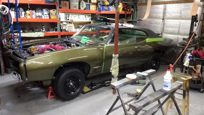

That's the OEM Verdoro Green ... or at least it's supposed to be
That's looking really nice and Verdoro Green is my favorite color for 68-9. With your willingness to wet sand and polish. That will clean up a lot of the dust bunnies we get painting at home.

Up on jack stands at the moment to fit the sheet metal.
You should have the car on the ground to fit your sheet metal. The frame can flex a little when on jack stands.
Looking nice though!

The front jack stands are under the sway bar bushings to flex the frame as if weight was on the front wheels rather than under the frame at the cowl so that the frame hangs down. I've definitely seen the flex when they are under cowl/frame.

I've gotten down a polishing system that seems like it's going to work for me. Some photos of the worst piece of metal on the car. This fender was a MESS, a drilled holes and dent puller kind of mess, I took out filler 1/2" thick in places, front corner bashed in, eyebrow over the wheel well bashed in, 80% of the entire time I spent on body work on this car was on this fender alone. Still no where close to perfect, but I can live with it.

... Still no where close to perfect, but I can live with it.
I don't know, looks pretty dang good to me!
