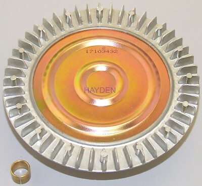

Wow! That non-thermal clutch really made a big difference.

Yep I think that's going to be my first go-to should I have any low speed overheating problems.

Non thermal clutch has no coil on the face.
