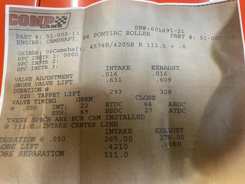

This is the one I am
Going with (first one)
Other one is available (second one)
ID:	663829   Click image for larger version
