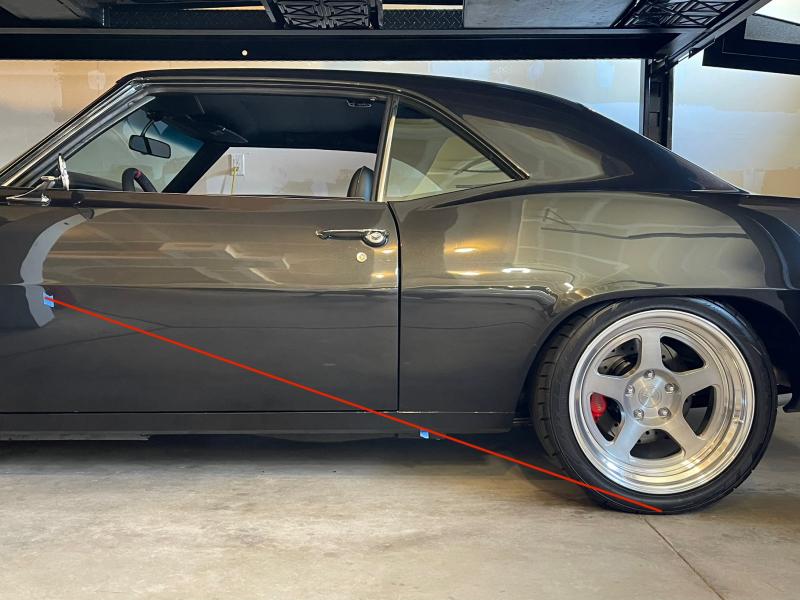

I put this together quickly on my lunch however. It's a "good enough" plot of the anti-squat line on my car. If you know your total vehicle weights and front and rear weights it's fairly easy to plot.
My car weighs 2000 lbs on the front and 1402 lbs on the rear for a total of 3402 lbs. My car has a measured wheel base of 107". If you take 1402 x 107 you end up with 150014. Divide that by total vehicle weight of 3402 and you get 44.10 which is inches from your front centerline. This give your your center of gravity position behind the front wheels, but does not give you it's height.
The easiest way to do this and how most people do so is to use the height of the cam. There is a formula to arrive at the exact height but it involves taking weight measurements front and rear, the independently lifting the car 10" front and rear and taking measurements again. For most purposes, using cam height is good enough.
You'll see the CG as the top most blue dot on my car door. The lower blue dot is the location of the forward spring eye on the leaf spring. This is your forward link and where all torque is being applied to push your car.
Now you can draw a line from the centerline of the bottom of the tire, up to your CG and see where your forward link is in relation to the anti-squat line. Notice on mine that my forward link is below the AS line. Not by a lot, but definitely below. This would be a percentage of AS below 100%. Lets' call it 97% here.
What this means practically is that my suspension will allow a bit of squat under power. This increases the suspensions ability to deal with uneven pavement, bumps, or even acceleration off corner. However because the suspension is allowing some squat, available power to the wheels is reduced and some traction is lost.
Notice that with a leaf spring, the physical mounting point determines your anti-squat, unlike a link style suspension. What that means is you can play around with your anti-squat by changing the relationship of the mounting point to the AS line. If you lower the front of the car, this will tend to increase AS. If you raise the rear, especially in relation to the front, your AS will increase.
Drag cars will run AS percentages between 120%-150% or so, depending on the type of suspension, tire used etc. It's not an end all be all here, but it gives you an idea of what you're up against with a leaf. All of this also assumes that you aren't overpowering the leaf and causing axle wrap. The wave that forms in the leaf pack when this occurs loads and unloads the tires. In this situation you'll either blow the tires off completely, or induce wheel hop. That's one of the things the cal-trac is aiding in. It's also adding some separation of the suspension, making it act like it's got more AS percentage.
On a performance street car that cares about more than going fast in a straight line, having AS percentages below 100 is pretty typical. This becomes somewhat neutral and provides off corner traction, braking stability and less oversteer.
Might be worth taking 20 minutes and plotting this on your car. Might be eye opening to see where it is.

Very interesting. I'll have to go weight my car and plot that out.

Yeah I went back and realized you're running a 27" tire. There's only a single 27" tire offering in the Azenis line which is a 295/40/18. So you'd need an 18" wheel, which honestly is a better size currently. There's far more tire options in 18" wheels than there are 17" wheels now.
I'm fairly certain a 10" wheel with a 295 tire is possible on a stock tub 2nd gen, but you'd have to measure it out if you went that route. The problem is that there's no sizing like that available for the fronts.
Honestly, you're in enough of a quagmire here based on the look you're after as well as what you are and aren't willing to modify, that you're going to have to choose between longer lasting street tires that don't provide the level of traction you're after, or drag radials that provide the traction you're after, but need replaced often.

For what it's worth, modern 17 and 18" aluminum wheels and their accompanying tire weigh less than older steel based wheels and larger tires. Given the same overall tire diameter, you can actually decrease moment of inertia with modern larger wheels when compared to old steel wheels.
That doesn't make that article wrong, but it assume that overall heights change as well, when in reality, most people stick with the same overall tire height.
I always look at what parts people are running that are winning in whatever discipline you are interested in. Autocross is the best analogue for our street cars, because the speeds are largely the same and the maneuvers tend to be tighter, vs long fast sweeping corners present with open road racing. For a "canyon carver" autocross is the best comparison.
We can use Mary Pozzi's second gen Camaro for this comparison. This car is well put together and has a great driver behind the wheel.
Wheel and tire package includes Forgeline Wheels in 18" square setup. 315's front and back. It uses a 27" overall tire diameter.
It may have an independent rear now, but for a long time it used a speedtech torque arm and coil overs up front.
Efrain Diaz's 69 Camaro is setup very similarly. It uses 18" wheels with 315's front and back, again on a 27" overall diameter. It too is on a torque arm rear.
Now if you want to look at cars that are winning shows and are less concerned with performance, the hot setup that I personally like and see a lot of is C6 GS/Z06/ZR1 fitments. 18x10 in the front with a 19x12 in the rear. These will run a 27" diameter in the front and a 28" diameter in the rear. Very high performance tires are available commonly in these sizes, as are all season tires.
The point I'm trying to make here is that sometime you have to follow market dynamics, which don't always care about physics. You may have the perfect setup with a 17" wheel, but then find that the perfect tire you need doesn't exist. But you might be able to get that perfect tire if you upside to 18" or 19", and unless you're chasing every 10th, that type of deal is going to take precedent over perfect physics.
