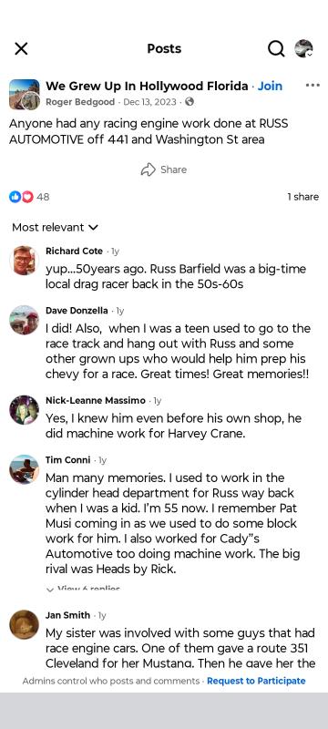

Really, I think it's more plausible these heads were done by these guys rather than a secret Pontiac back door operation..... JMHO
