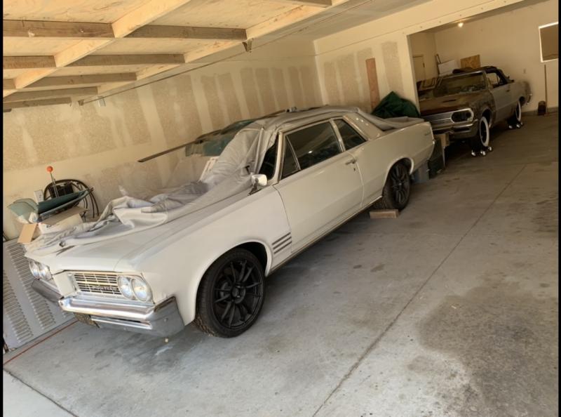

That old intake you have matches up to inferior early heads that were on engines that had a lot of differences I don’t want to get into.
Suffice it to say you’re going to need a 1964 intake, assuming the engine is still a 1964. By now a lot of them have later engines and heads that only fit 1965 and up intakes so make sure what heads you have. You can identify the heads by the casting numbers on the two center exhaust ports.
1964 GTO engines all came with 9770716 heads, pictured below.
After 1964 the intake manifold bolt pattern and water crossover design changed. 1961 - 1964 intakes will interchange however only 1964 intakes had a high rise design, they are unique.

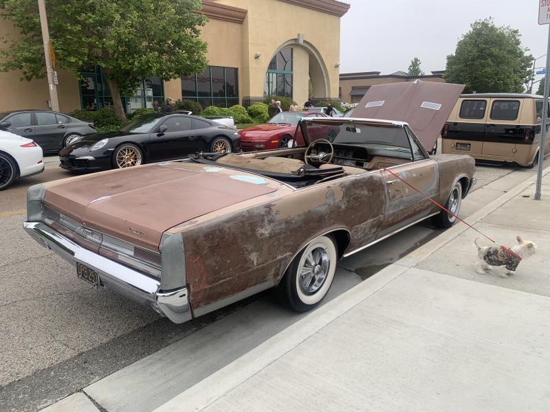

As long as we are posting pictures of ‘64 convertibles here is another. Basically done except for some minor odds and ends.

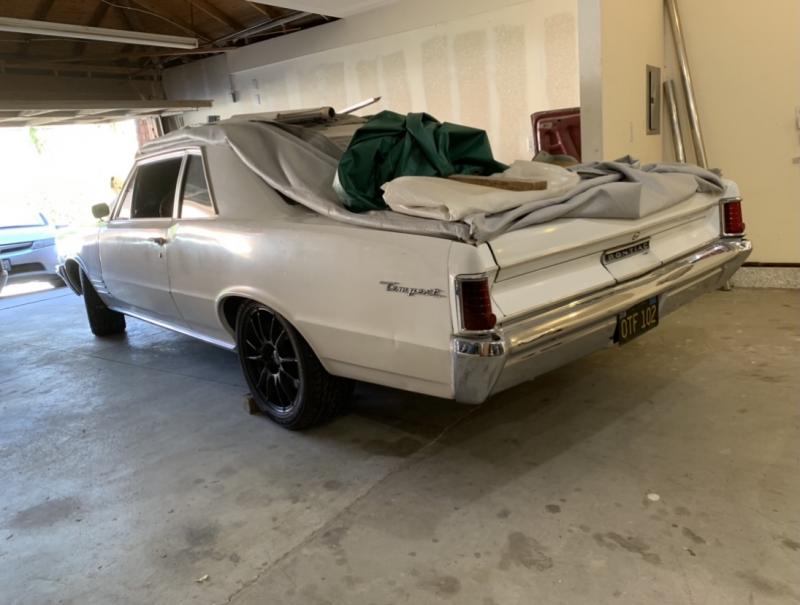

My ‘64 Tempest Sport Coupe.
Waiting for attention, viewed through the rear side window of my ‘57 VW project in my crowded garage.

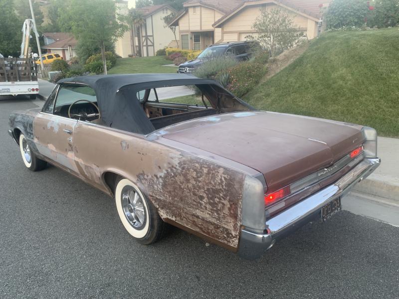

That rectangular mirror was already on the car when I bought it in 1996. Just an aftermarket mirror of some sort. I have a couple of decent round remote mirrors with cables to choose from that I’ll use on my Le Mans convertible as it was originally equipped with one.
Staying a low-line Tempest for as long as I own it, originally a 6-cylinder 2-speed automatic car. Still wearing most of the original white paint with a few body shop touch ups here and there in varying shades.
I really don’t care about perfection, I’m just happy to have them running and looking the way I want.

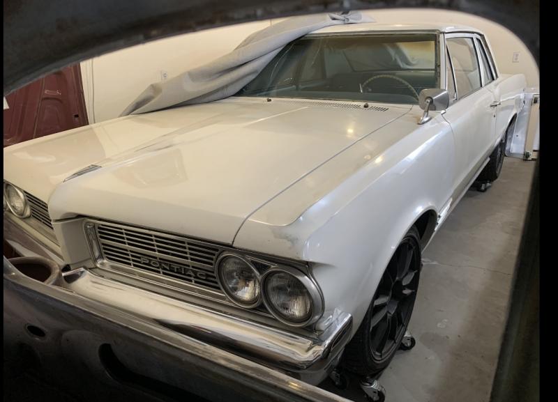

That was one of the first things I noticed! My Tempest originally had the remote mirror, but I’m just not a fan of the fender mount. The mirror image is too small and the placement is not appealing IMO. I put a standard mirror on in its place. Here is the “barn find” shot of the Tempest in my wife’s grandmother’s garage in ‘03.

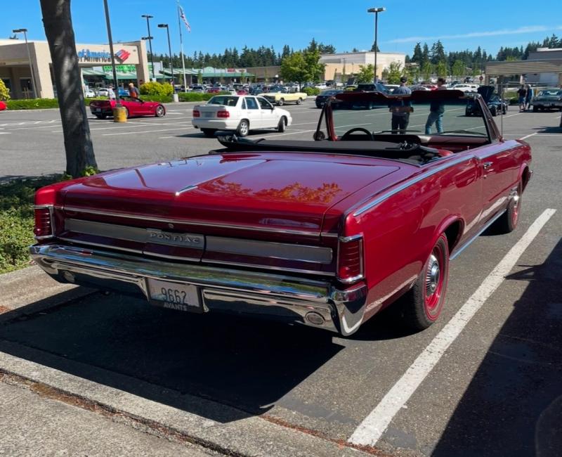

'65 LeMans post car. GTO badges hung on it several owners ago. Built 400 and a 4-speed. FUN, fun car!!
