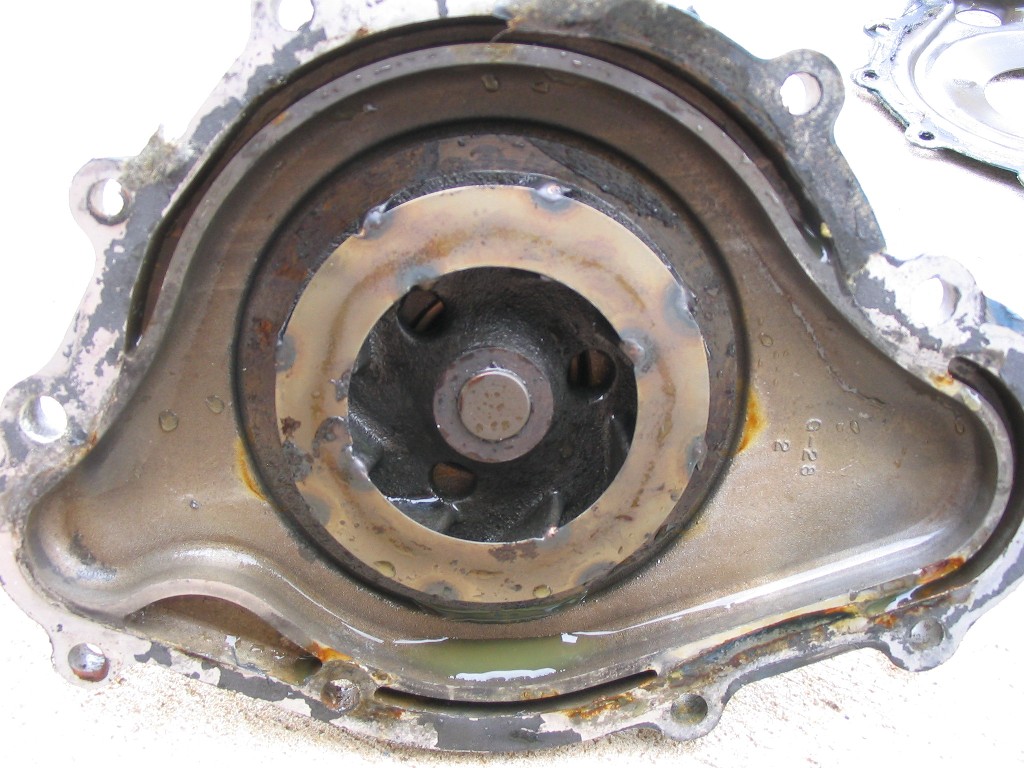

I just swapped my aluminum Flowcooler pump out for the NOS pump I bought. Here's a picture of the .160" gap between the Flowcooler impeller and the divider plate.

Here it is.

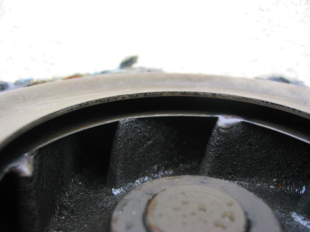

Here's one of the pump itself. It has a cast impeller with a metal plate welded to it. They chose to turn down the outside diameter to 3.775 from 4.400". The vanes are 5/8" deep like the factory one.

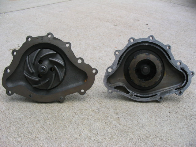

Here's a picture of the two pumps for comparison.

The picture of the new pump to divider plate didn't turn out very well. With a new gasket and the divider bolted to the pump there was about .055" clearance. So, I left it alone. I will test drive it later and post the results. I predict it will do better on the highway,and similar at idle. I'm fabricating a shroud. It should be done soon. I think it should help the idle cooling big time.
