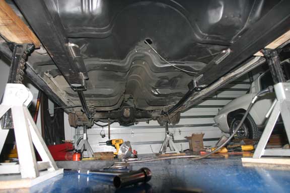

I finally got back to the car this weekend and installed the subframe with the Alston connectors. Here is a picture of the underside from the front.

Looking from the rear you can see how the Alston connectors go to the rear frame rail instead of the traditional front spring mount. The subframe is actually about 4" shorter at the rear than the stock subframe. So I was only just able to get them to connect to each other. I have boxed in the connection for strength.

Right now I have only one bolt in each rear subframe connector. I drilled a tight bolt hole with the connector hard up against the frame. I can now remove the entire assembly for paint and build up. I can then (fingers crossed) reassemble to the car after the body is painted using the 2 bolts for alignment. Then I will weld the rear connectors to the frame rails.
