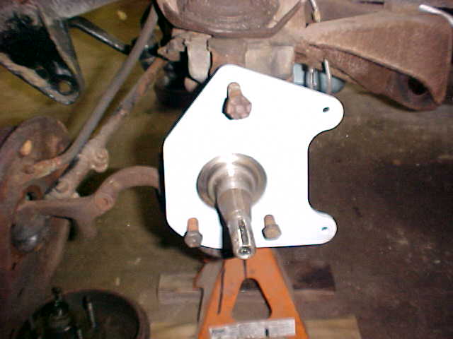

He's a picture while installing. I purshased them from Jim and they fit fine. Be carful separating the brake drum from the hub the lugnuts are rolled over to hold the drum to the hub. It was easy to just cut the studs off and grind them flat to the drum and then press the heads out. Have fun!!

I purchased my from Jim and they fit fine.
