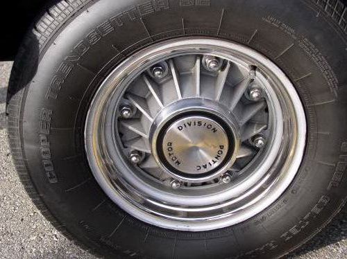

Cooper Tire still makes and sells a 225/75/14 "Trendsetter SE" tire, it's 27.3" tall. They also sell it under the Mastercraft IV all season brand name. Here's a pix of it on an 8 Lug wheel.
