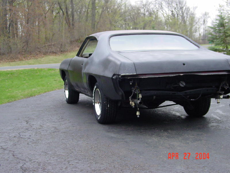

great post mootie!! going to consider leaving my ride height where it is at

Cutting off 1 full coil dropped my front end by about 1 - 1 1/4 inches. For every 1/2" (not coil, inch) that you cut off the free height of the spring you will lower the ride height APPROXIMATELY 1". Cut the end that is NOT flat and put that end down in the lower A-arm pocket. It is not an exact science, but when your car sits high like that you have no choice.

OH! I like the stance on your goat slash! Well.. maybe the back is a tad high for my liking.. but hey, to each his own. I have a 68, any suggestions for rear springs? I got global wests for the front, will redo suspension in a month..
