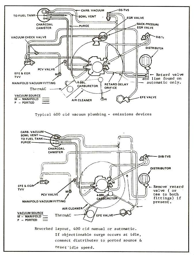

BTT: 3tas4me Looking back to your original post I remembered and dug up for you the reference material I used to “Super Tune” on my original TA and those to follow (including our current 1978 & 1979 W-72 4-spd’s). Click on the images here and they will link to the med versions of each “how to” page.
FWIW & IIRC: Our 1979 Y-84 W-72 4-spd TA has had HO Racing HCO2(?) Cam, Factory Q-Jet Jet Kit, Tri-Y Headers, Performer RPM intake, and Pontiac #96 (1971 GTO 400) heads installed. Some other HO Racing recommended “tricks” were used too. However - The factory A/C, Shaker Scoop, 3:23 gear, etc. all function as normal.
The vacuum routing shown below is also used:

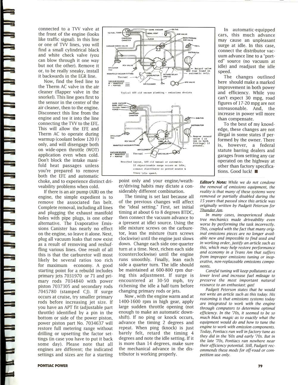

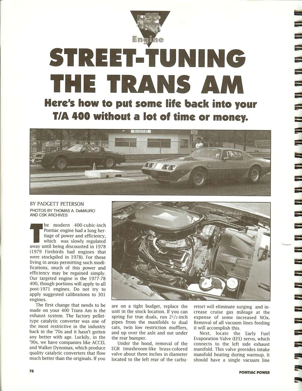

Article included (2) pages how to “Street-Tuning The Trans Am”
Page 1
Page 2
Re-routing hoses full size blowup here
Important Note on Layout:
If objectionable surge occurs at idle, connect distributor to ported source & reset idle speed.
