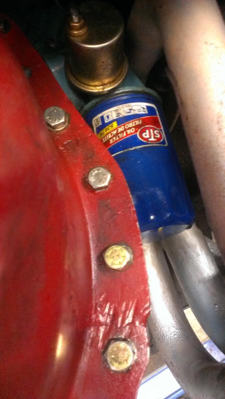

Remember this thread? I just remembered that I wanted to put back an STP oil filter to see if my oil pressure goes back up to where it was. I was smart enough to take as picture of it before removing, but not smart enough to take a CLEAR picture.
Can anyone make this number out? I don't think this was a Pontiac number filter.Click image for larger version
Can anyone make this number out? I don't think this was a Pontiac number filter.Attachment 395598

Well, just to say, I would never run an STP filter. AC, Wix, or K&N, in that order of preference for me, though some will say Wix first, due to AC changing design/quality.

Well, in the fall I switched from Dino to Amsoil and a K&N filter. My PSI dropped, especially when warmed up. I talked about it before, I think on this thread. Over the winter while parked there was also some oil leaking from the front of the pan where it didn't leak before. Slippery stuff.
Anyway, I thought I I'd at least swap oil filters back, even if temporarily, to see if the pressure comes back up.
Oh, and my dipstick pushes up now and it didn't before.

I've noticed K&N filters usually do show a slight drop in psi, because they filter to a smaller micron. They also clog faster, and require changing more frequently.
Still say use a PF24 or Wix.
