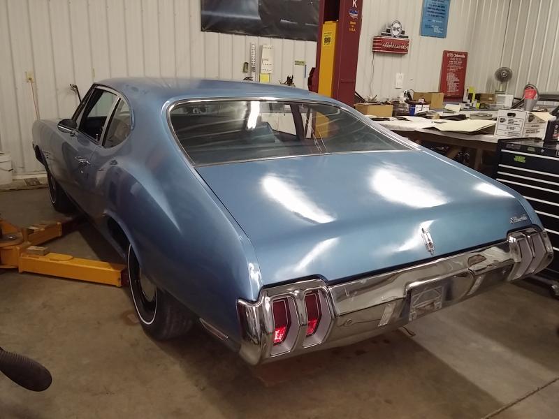

Roger, Thanks for the schooling on the GP driveshaft length being the same as the A-body. I forgot about the engine setback with the deeeep fan extension on the radiator shroud.
Dan recently bought a true survivor 1970 F-85 Olds with 39k miles and 100% original. It is a factory 310 hp 350/TH350/3.23 high altitude gear car. It is totally rust free high dessert car (SW Colorado). The paint is tired but the interior is mint (Olds version of Bermuda blue with optional blue vinyl guts), the point is it has the same rubber isolated driveshaft and has the correct stripe code colors for Olds. Soooo, I'm thinking it may have come from another F85/Cutlass. I wonder if Buick Skylarks had the same shaft....?

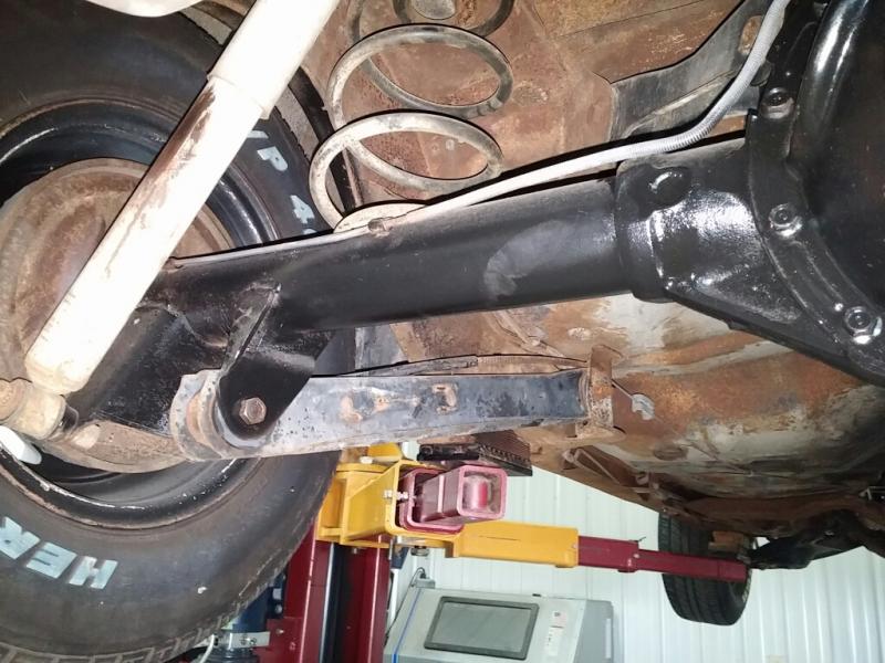

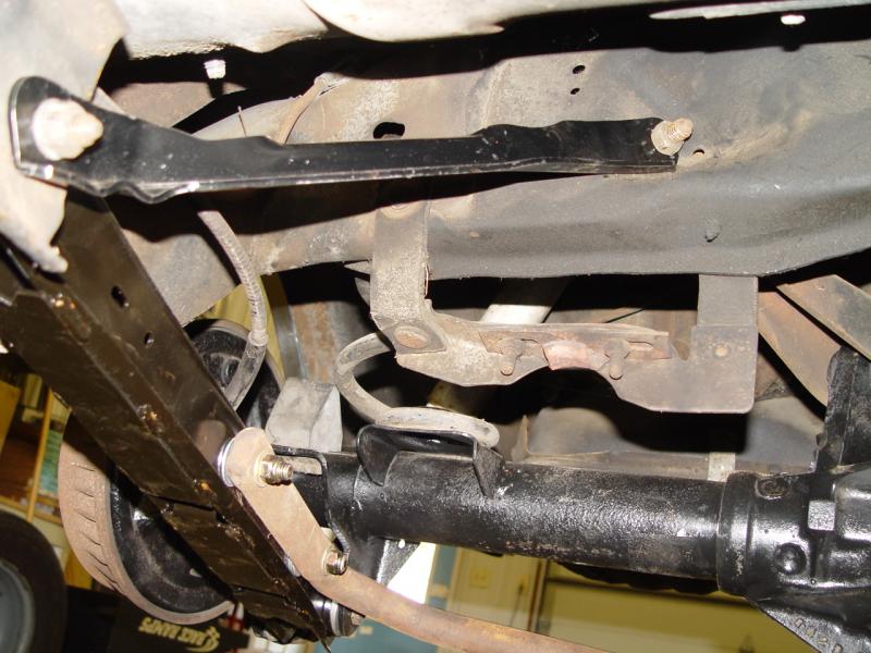

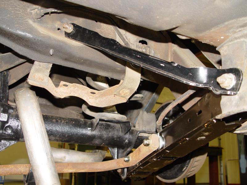

Wouldn't the manual trans (especially with a 455 HO/M-22) car been equipped with the rear fram reinforcements like on the GTO's?

BTW, the pictures in my previous post are of the Ames repops we installed on my 70 Lemans. There aren't any on the GT-37 right now and not sure there ever were.

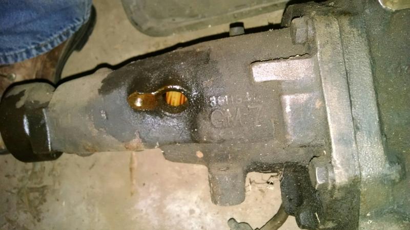

Also appears the M-13 may not be the original trans. No date VIN on the pad and the casting dates are B, D, & E of '70 which is probably too early.
Any thoughts?

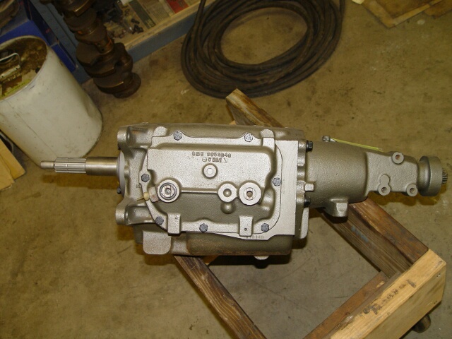

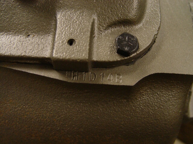

Here is another '71 M-13 for comparison...

As far as VIN stamped on transmission. My old Fremont built M-22 didn't have that stamped?

I could check the M13 from mine - see what the date range is on it.
Chris, That would be interesting to know. It very well may be since the were infrequently installed/ordered, that there was extra '70 casting M-13's to use up. Strage that it doesn't have a VIN or the stamping below the side cover.

Texted pics to Dan - no VIN on my trans either.

I'll do my best to shed some light on any mysteries uncovered in this thread, but I owned that car for a LONG time and had a lot of engines in and out of it. I can tell you the trans was the one in the car when I bought it in 88, and I always wondered about the missing VIN. I find it unlikely that the original owner blew up the M-13 and then replaced it with another. Possible, but does not add up to me. And as far as I know, thats the driveshaft that was in the car from 88 as well. I did a lot of cross breeding of parts among my fleet back when I was a kid, but that was my only car with the Chevy rear end yoke, so I think it was always in that one.
