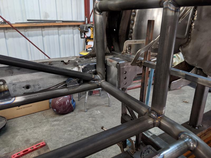

Looking good Erik! Just curious what are your plans for mounting the leaf springs?
  #44
Old 03-18-2020, 09:08 AM
ErikW's Avatar
ErikW ErikW is offline
Posts: 1,393
Leaf spring buckets will attach to the dropped x-member. We have some really nice adjustable ( multiple holes) heavy wall buckets. They will be braced into the cage also. Then the factory rear frame rails will be boxed and tied into the chassis as well. Stay tuned, that part is coming.

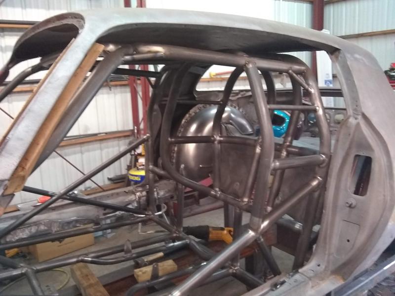

Default More Progress
The cage is starting to get crowded! Nick adding more tubes. I take my shot at skinning the doors. Not as hard as I thought it might be. Took the holesaw to the door shell while I had it apart to do a little "swiss cheese" treatment. Trying to lighten up this old girl.
