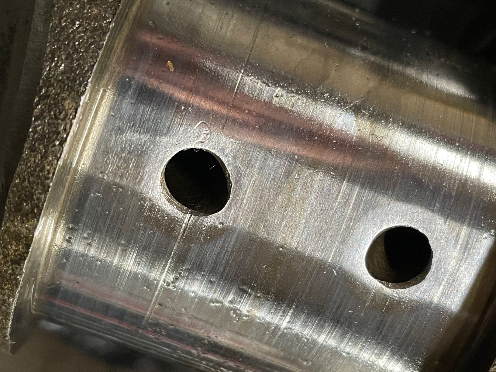

Those pics are really great and show allot. IMO, you have so much damage and variable amounts of wear throughout, the safest approach would just be a complete overhaul and measurement of all the components. Just no way to determine the level of parts replacement necessary to make the engine 100% again. I can determine a couple of things from the pics. No way in IMO, that crankshaft can be used again without grinding and polishing correctly. You can polish that thing till the cows come home and all your going to get is a smoother, out of round and tapered crankshaft. So it needs attention. While it is being reconditioned, the serrations can be dealt with as well. The root cause of the majority of the damage was a dirty assembly from what I see. I also see evidence of cap grinding that was done with a "packed" grinding wheel. Meaning the wheel was not dressed properly to open the grain and it leaves a burnished finish rather than a cool, clean ground surface. I can see this on the main caps and rod caps. Possibly the cylinders can be saved with just honing for a 2618 alloy forged piston. They can run up to .006 clearance which gives you some room to work with. The cam and lifters look to be in about the best condition of what I see in the pics. Sorry for the bad news. At least you caught it before something came apart or overheated and seized. It can all be fixed. FWIW, I prefer the 2-piece BOP seal. Easier to install and I have never had one leak. Other people have had different results.

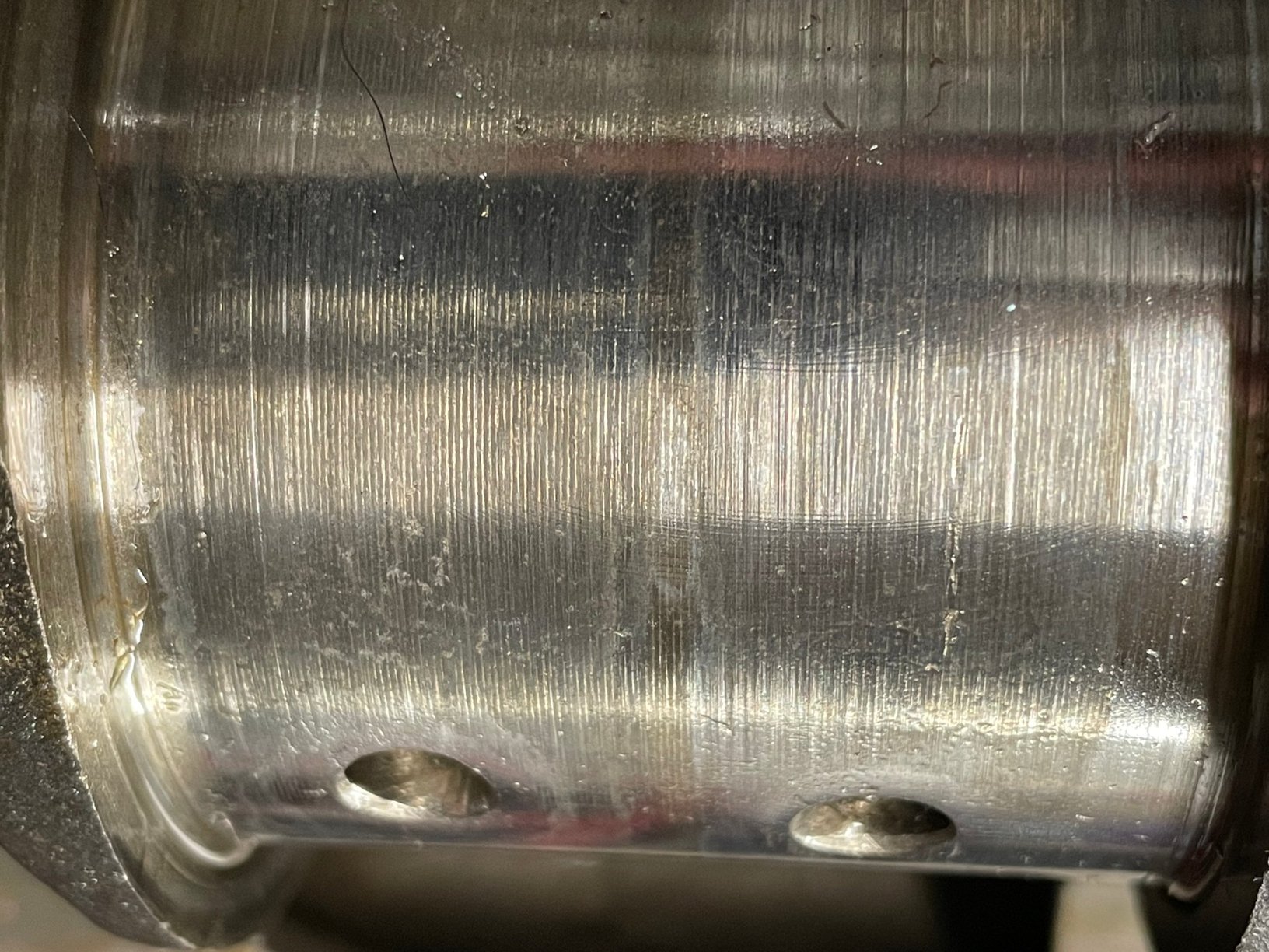

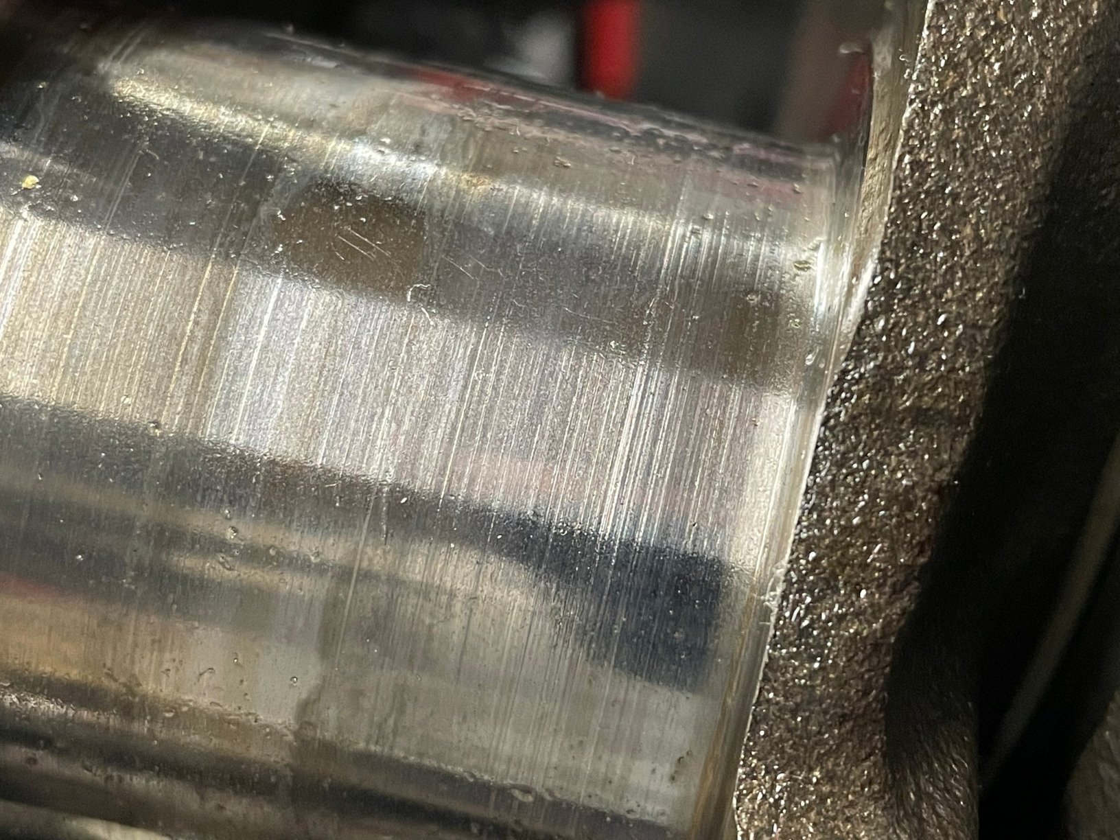

I'm there with you. I don't think there's anything to reuse other than the bare block, assuming it's ok. Would be a shame if it's not since it's original to the car. On every build in the past I've had to compromise somewhere. I'm in a spot now where I can go slow and build this thing the way I've always wanted to. I've also picked up a ton of knowledge since the last time it was built, but I still feel like a neophyte even after 30 years with this car.
I'm really impressed what you can pick up by looking at the pics. It speaks to your experience. Obviously I'm disappointed in the outcome here, mostly because I held the shop that built this engine in high regard. I'm almost certain the death knell was when it ate the valve stem seals, which was their fault also for being sloppy with the valve guides.
Yeah, at least I got it now instead of too late. The signs were there. When it was built, the machinist told me to use 10-30, but I was never comfortable with the oil pressure at that weight so I ran 20-50 to compensate. In the back of my mind, I knew something was wrong.
At this point, it seems I should start by getting the block checked out to see if needs if it needs to be bored, then I can move ahead choosing the stroker assembly parts. Seems like a 4.25 stroke and 6.8 rods are a given, just need to figure out the specifics of the pistons.
The BLOCK , FIRST.. Can it even retain oil ???
I've got some parts coming this week and will try the test you mentioned with the flashlight. There was a good collection of grease behind the power steering pump by the fuel pump. Could have been from the front seal.
Might be a dumb question, but presuming it has been align bored, couldn't you get a thicker bearing that would put the crank back in the right place?
The other bright side to all of this is my 14 y/o son has taken a deeper interest in the car than he ever has. He was really into tearing it down and wanted to know about each part. He asked me why the cam and pushrods were in the trash today. In my mind I was like "Yes! He recognized a cam and pushrods!"

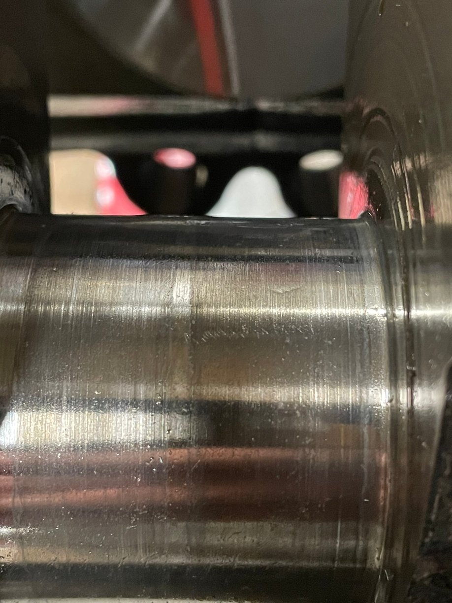

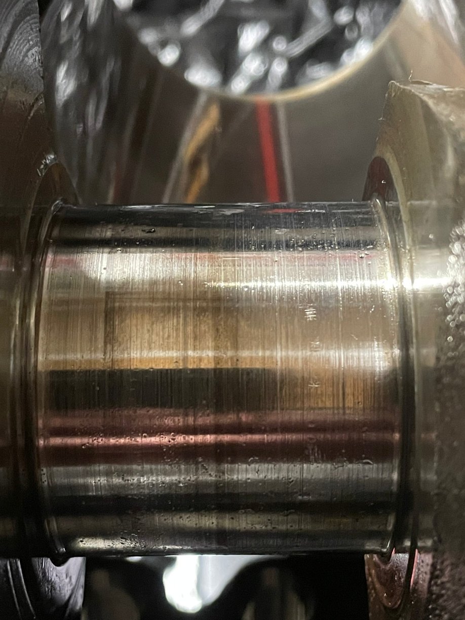

Might want to start with a good look at the crank.
Even though I'm not going to use it, I went back to look at this area of the crank. It seems the pic is showing something that's not there. But, I think mgarblik is right, this thing wouldn't clean up with a polish. It's scored pretty bad, discolored in spots and even has a few divots in it. One looks like it's from a rod bolt, which could have been my doing.

Some thoughts after looking at these pictures. It makes a perfect case for using a by pass oil filter to remove particulate that will continue to circulate right past a full flow filter, without being removed from the oil. All the fine abrasives are going through the engine over, and over, tearing up all the tightly clearanced parts.
Perhaps the engine wasn't properly assembled when it was built, but the damage could have been minimized had the fine abrasives been removed the first pass on the by pass filter. Recirculating for miles and miles did grind up all the wear surfaces within the engine, as evidenced by the pictures.
These pictures also mirror an engine that has a lot of laps in a dirt track car. Fine abrasives enter through the air filter no matter how good the filter is, then work past the rings, and into the oil. If left in the oil, it produces results much like these pictures show. They recirculate over, and over, grinding away the wear surfaces.
If the OP hadn't decided to repair his rear main seal leak, the carnage would have continued, until likely there was a mechanical failure, or he saw evidence that the engine was producing metal filings.
I know, "By pass filters have no place in a hobby car", I heard that somewhere before. But when that one part fails, and starts producing fine grit, unknown to the owner, a better quality filter may at least be able to salvage some of the internals. It may also stave off spinning a bearing, causing catastrophic failure, namely a connecting rod through the block.
The by pass filters I use, have all the removed particulate right at the end of the filter. If there is metal, you'll see it when you change the media, it can't be avoided. If you're not cutting open your oil OEM style filters, you have no idea if there is metal accumulating in the media.

I agree 100% with Brad, but First, ... BLOCK, BLOCK, BLOCK....... Can it hold the crank where it needs to be to SEAL...after it had an "align bore" ??
>>> POST # 1... >>>> OIL LEAK...........<<<<
I see you addressed this in post #44 , and that's a relief!
A true Align bore corrects the angle of the crank to the bores typically after the bore is done to correct an out of round bore.
The goal is to "re" achieve the 90 degrees. Typically the bore plate corrects to the exhaust side of the block and therefore the crank has to get moved up.
( as I understand it and was explained to me )
If you have a 5 under chain, your block was Align Bored.
You can't put "thicker" bearing half in the block and thinner in the cap to compensate.
For the rear and front oil seals to work that crank has be dead on where it was when new. It will not take much to make it leak.
I have seen 2 Pontiac blocks leak for this same reason ( other reasons too on 1975 and 76 455 blocks) .
Even if you change Blocks, you still should get your final assembly smoked, even if you get it dynoed after.
